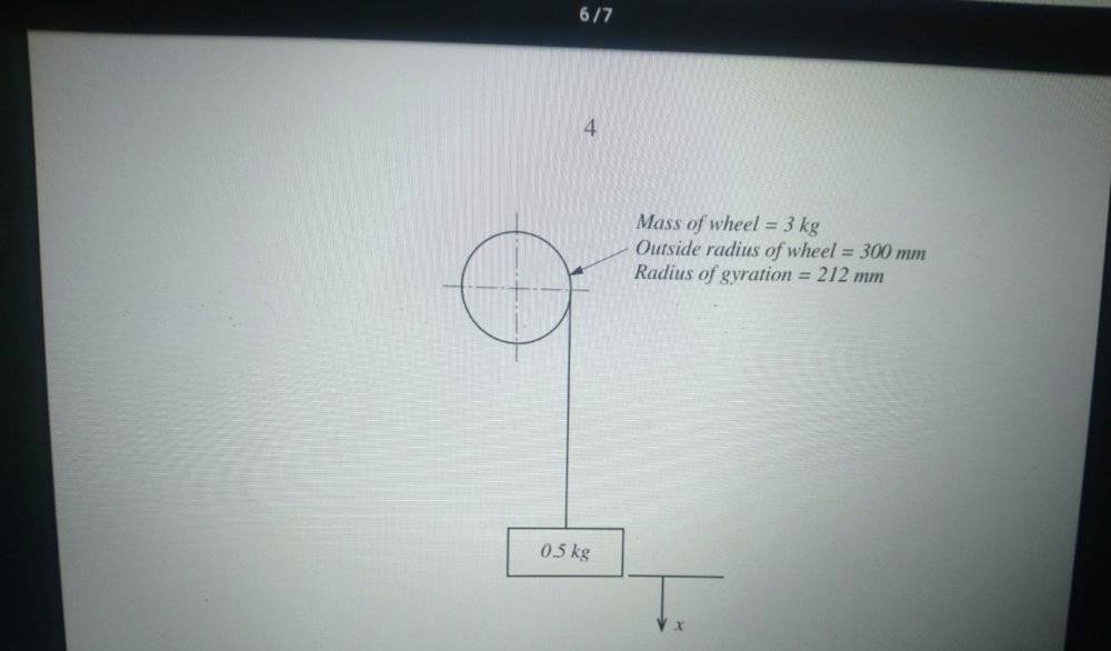

A mass of 0.5kg is suspended from a flywheel is released from rest and falls a distance of 0.5m in 1.5s ,calculate the
linear acceleration of the mass
Σ Torque = I x a
Σ F = m* a
Im I right with the formulas?

But, in any case, if you know the distance covered in a given time under constant acceleration, surely you should be looking at (i.e. selecting) one of those pesky SUVAT equations to give you a.
Also, no one mentioned the value of I so that is not going to turn up in any formula that's useful.

so it means ; d= VoT + 0.5 at (2) ?
That formula should do it (when you actually copy it correctly). Note: it's a lower case "t" both times., initial velocity is zero and it's t2 in the right hand side. You have values for all but one variable so you can solve it.
yea thanks but can't locate the keys to achieve this t2
0.5 = 0*1.5+0.5*a*1.5 ^2
0.5 =0.5*a*1.5^2
=a*1.5^2/ 0.5
=a*1.5^2=1
a =1/ 1.5^2
a =1/2.25
a =0.44m/s^2
hoping I am on the right track
Looks ok to me. The flywheel is effective at slowing the rate of fall!

Not quite. You put "a" in both, but in the first equation it should be an angular acceleration, usually denoted α (alpha).
Anyway, as @sophiecentaur mentions, neither is what you need for this question.
