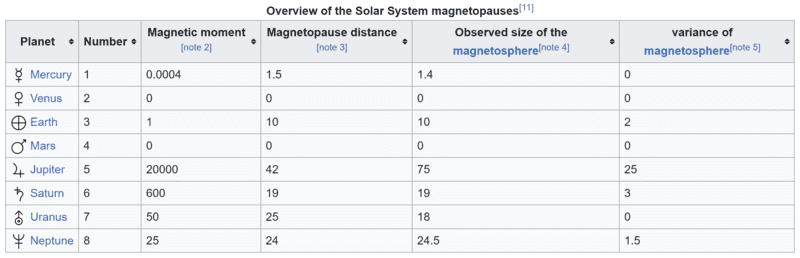

This table of planetary moments (relative to Earth's) and magnetopause distances (in terms of planetary radii), from the Wikipedia entry that @TSny cited, should help answer some of your questions and serve as a check on your calculations:
