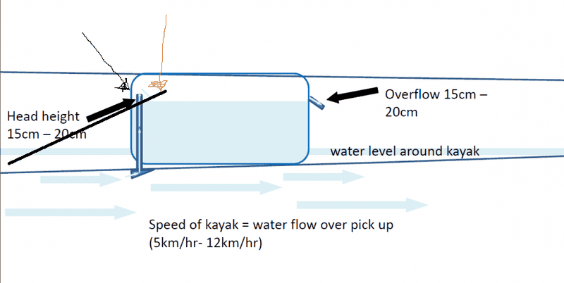

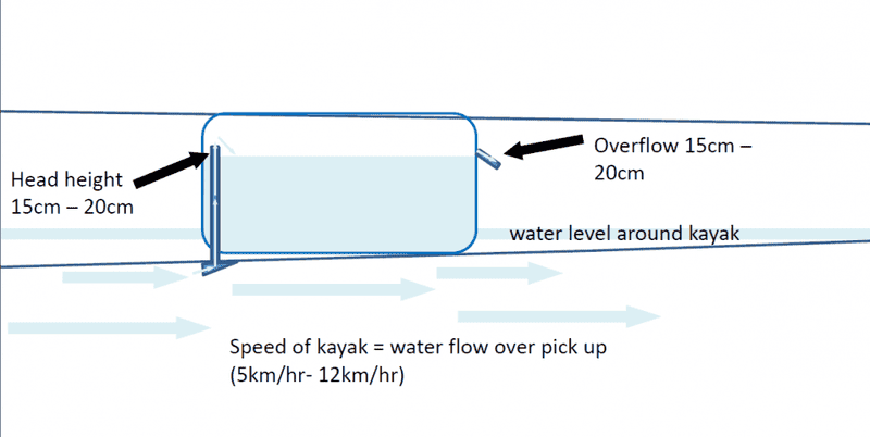

Hello bright minds,
I have a practical problem for which I need help solving, and I'm sure someone could help.
I am wanting to place a pick up (sort of a backwards facing venturi type structure) under my kayak to fill up and supply a box with fresh water for my live baits. I would like to know how one would calculate the required velocities of the kayak (if possible, including friction in pipes) to be able to overcome the head height (about 20cm max) to fill my box. Please see my simple diagram for a visual description of what I am trying to do.

Use
Bernoulli's principle
but it has no consideration towards effects like viscosity, friction in pipes
i think , u can considerably lessen the severity if these effects by
making the tube less steep, as shown by thick black line(pointed by red arrow)
this will lead the incoming liquid to the container without much Deterrence(and water flow will be less chaotic)
so now use this equation , with following considerations- pressure at head end is Patm, pressure at the tail end is ρv2**,velocity at the tail(other end of the tube- thick black line) to be v (velocity of the boat), h as height of the head from the water level around the kayak (asuming elevation at the tail end to be zero)

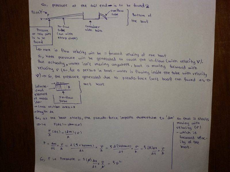

Shreyas Samudra said:
See the file -finding pressure at the tail end is ρv2
See this

Aha! I can view it now, thank you so much for the effort of using and solving the equation. I will play with it this weekend and see what I come up with. And to Anorlunda, yes, I will also get to try out the pipe strapped to the side of the boat this week!
