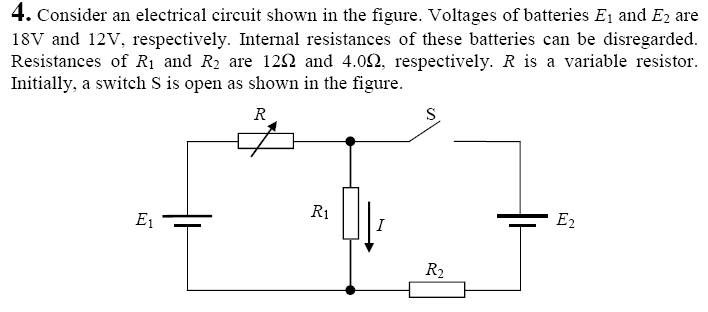

before that, can you tell me about "current flow in this circuit" if :
A. the switch is open
B. the switch is closed
the Question is
No. 1 Calculate the resistance of R if the value of the current I in the figure is 0.50 A. ( i think it is related to no 2)
no 2. Calculate the resistance of R if the switch S is closed and the value of the current in
the resistor R2 is 0.0 A. (what i want to know)
Kirchoff's Law (I & II) (i think i missed something because if that i can't solve this)
V = I R
my thoughts are:
1.) what i thought is because the switch is open, the current will ignore R2 and E2, and just go through R and R1(R and R1 will be series)
that will be ez to find out R for no 1.
V / I = R
18 / 0.5 = 12+R
R = 24
2) when switch is closed, it has 2 battery and its voltage will be 18V (if both of the batteries have same voltage) but in this case its have different voltage.
after i search it, someone tell battery with higher voltage will destroy battery with lower voltage. then the voltage for this circuit just 18V.
and because higher voltage will destroy the lower one, how current flow for this circuit.and please correct me if I am wrong

No, the batteries are safe. There's resistors in the path of their currents which will limit the current flow and create potential drops between the batteries. It's only when (ideal) batteries of different voltages are directly connected in parallel that you need to worry about the current and power becoming unrealistic (heading to infinities).
Think about what conditions must exist for there to be no current drawn from E2 when its branch (E2 and R2 in series) is connected. What drives current in a circuit?

FJay said:
because all the voltage used by R3 ?
There is no R3 on the drawing. The phrase "voltage used" is troubling. Voltage is not something that is used up. Instead, "voltage" is the potential difference between two points. If no current is flowing across R2, that means that the potential difference between its two terminals is zero.
FJay said:
because the batteries have different voltage, the higher voltage will charge the lower one until they have same voltages
If there is no current flowing across R2, how much current is flowing across the right hand battery?
i get it now after searching some images.
because it has junctions we can Kirchhoffs Law I
I1 + I3 = I2, because I3 = 0 then I1=I2
using Kirchhoff's Law II find loop for both sides
E2 = I212 + 0*4 ---> 12 = 12I2 ---> I2 = 1
E1 = I1R + I212 ---> with I=1 ---> 18-12 = R, R=6 ohmsThx for your guidance
