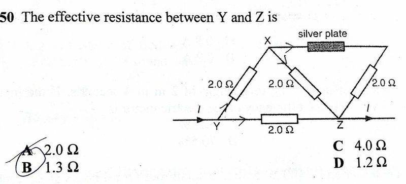

Why not? The electronics is different so you should get different answers.lelon said:Here is the question that a circuit with silver plate, i though silver plate will act as conductor but I can't the answer 1.333. If i assume it as insulator, i will get the answer 1.3333... why?
lelon said:Here is the question that a circuit with silver plate, i though silver plate will act as conductor but I can't the answer 1.333. If i assume it as insulator, i will get the answer 1.3333... why? Thanks for your help in advance.
lelon said:what i do is assume silver plate is conductor without resistance, so , my working is calculate node XZ , i get resitance 1/R = 1/2 + 1/2 where R is 1 ohm... then top part YZ resistance, R = 2 + 1 and I get 3 ohm. Last , I calculate total resistance in parallel circuit where 1/R = 1/2 + 1/3 where i get R = 1.2... Am I correct? ✔
