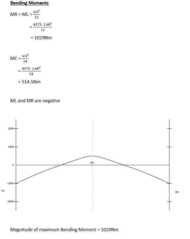

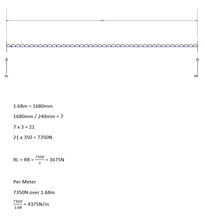

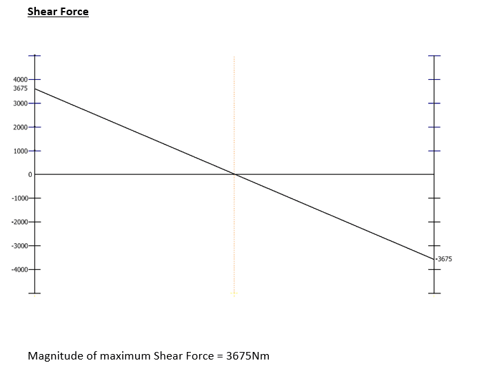

My answer:
I believe this to be correct. If it is not would appreciate someone letting me know so i can correct.

I am not sure I understand your concern. The shear and bending moment diagrams for the UDL case look good. For a point load at the center of the beam, 1/2 of the point load goes to each reaction . For the bending moments at the ends and center, you look them up in a table like you did for the UDL case. Then add 'em up for the total combined shear and moment (UDL plus Point Load).
Likes Ben_Walker1978
Yes that is what i wanted to know.
Thank you for your help.
