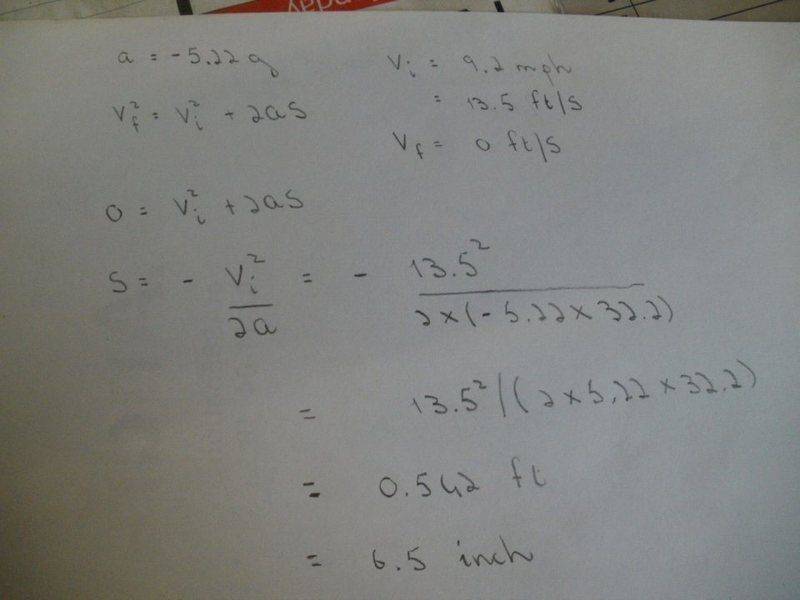

The object in question would be a forklift with the weight of the forklift, the battery invaded within, and the driver. It was traveling across a cement floor and hit a ramp going into a trailer. There was no load on the forks at the time. Our employer has an instrument attached to each forklift that, when you hit an object, supposedly measures the g-force of said impact. Each forklift has a governor installed to limit maximum speed to 9.2 mph. I am wondering if the is any scenario in which an object weighing that much and traveling at 9.2 mph could produce a g-force "rating" of 5.22. And if not, how fast would the forklift have to be traveling to register that.

The physics can only give a rough approximation by idealizing the impact...in actuality, there are a lot of variables and unknowns. I am not sure how you arrived at that one foot stopping distance. But assuming the forklift stopped in 1 foot and assuming it was traveling at 9.2 mph just before impact, then it's average deceleration would be about 3 g. If however the stopping distance was a foot and the avg deceleration was measured as 5.22 g, them it's initial speed just before impact would have been around 12 mph. Stopping distance is key...hit a wall of marshmallows and distance stopped is greater and g force a lot less than if you hit a steel wall!
Did the forklift battery and the driver "invade" the trailer as a result of the collision with the ramp?
Assuming that the ShockWatch is on the forklift it would need to come to halt in about 6.5 inches
to produce such an deceleration.
