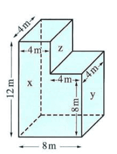

calculate the average force on the face "y"
F = 1/2 rho*g*h*A
Hi All, in the following problem:
the book solution
I don't understand why he added the term
\rho g h_{z} A_{y}
shouldn't it just be :
F = 1/2 \rho g h_{y} A_{y}
What would you say the pressure is at height ##h_y## on the x side?
I guess it will be ##\rho g h_{y}## but it will be a downward pressure.
Pressure in a fluid has no direction, which is to say it acts equally in all directions.
Likes MatinSAR
OK, so you mean the pressure due to the weight of water contained at the z part (##\rho g h_{z}##) will act also along the right side affecting the area ##A_{y}## hence its force = ##\rho g h_{z} A_{y}##, am I correct in this interpretation.
the confusing thing also is, if I use integration it gives an equation that is the difference between two values but also outputs the correct answer.
Yes. The pressure at depth h below the surface is ##\rho gh##, regardless of the route. So on y the pressure varies from ##\rho gh_z## at the top of y to ##\rho gh_x## at the bottom.
Would that be involving ##h_x## in the difference instead of ##h_y##? If not, please post the details.
