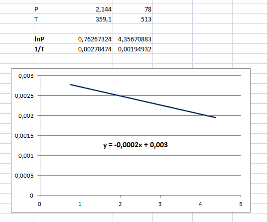

Hi Chester! you mean the 2 points ##(P; T)##:
##(2.144 ; 359.1)## and ##(78 ; 513)##
For these points, the linear equation is:
##y = -0,0002x + 0,003##
For ##ln (60)##, ##1/T## it gives me a very high and negative number.
What am I doing wrong?
Also, I know that the slope of that line should be:
##-ΔH_{v} /R##

The slope is $$m=\frac{\ln{78}-\ln{2.17}}{\left(\frac{1}{513}-\frac{1}{359.1}\right)}=-4288$$So the equation is $$\ln{p}=m\left(\frac{1}{T}\right)+b=-4288\left(\frac{1}{T}\right)+b$$So,
$$\ln{78}=-\frac{4288}{513}+b$$and$$b=12.72$$So,$$\ln{p}=-4288\left(\frac{1}{T}\right)+12.72$$So, at p=60, T=?
Likes il postino
