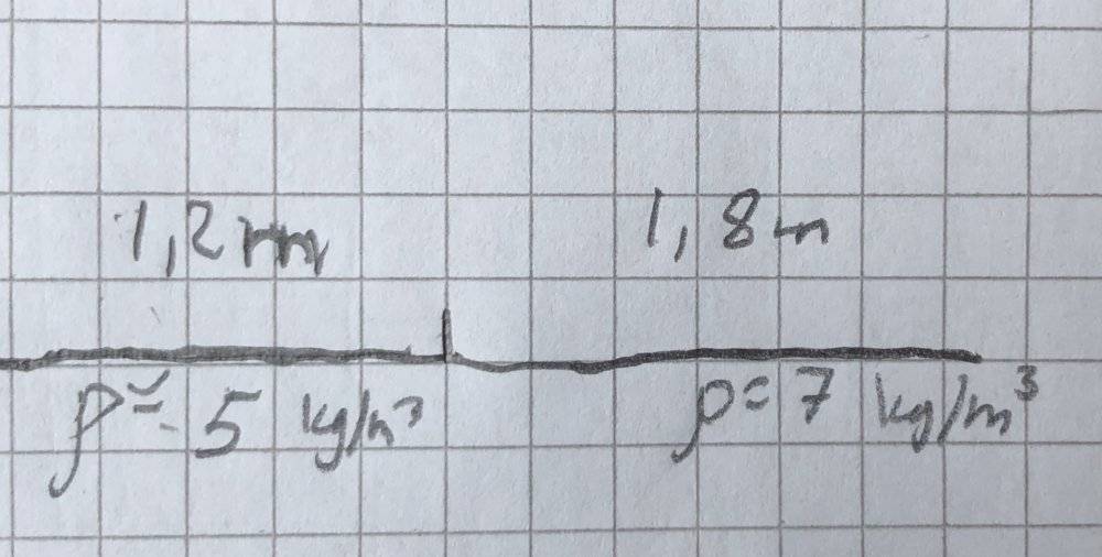

A metal rod consists of two parts. one part is a 1.2m metal with the density of 5kg/m3. The other part is a 1,8m metal with the density of 7kg/m3. Calculate the center of mass for this rod.
Density=m/v
I know that if they had the same density they would have the center of mass at 1,5 m. But now that they don't the center of mass will be shifted towards the part of the rod with higher density. they will have their center of mass where they
have equal mass
p1*v=p2*v
now i don't know how to move forward

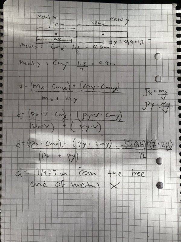

Is this correct?
VitaminK said:
you mean p1*v=p2*v --> 5*pi*r^2*l=7*pi*r^2*l now I am confused about the length l
Ignore what I said! I wasn't thinking.
VitaminK said:
Is this correct?
That doesn't look right.
Can you break down your calculation so we can see where you've gone wrong?
That is not the answer I get. To make your calculations more clear, I think you should specifically calculate the two masses, ##M_1, M_2## at two locations, ##x_1,x_2##. Then put them into a final equation to find the center of mass of two masses.
EDIT: Sorry, I see that you can not calculate specific numbers for the masses. You must leave the density in. But I think you can make your calculations more clear. I still think that there is a mistake in your calculations.
Likes jbriggs444 and PeroK
I see the problem. You need to be more careful about the volume. Assuming that the diameter of both parts is identical, the two parts do not have the same volume.
