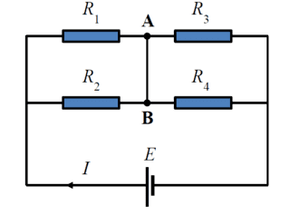

Calculate the current between point A and B

What is the current between points A and B?
The current I is unknown.
The voltage is 12V.
R1 = 3 Ohm
R2 = 6 Ohm
R3 = R4 = 4 Ohm
U= R*I
Total resistance from both branches:
1/R = 1/(R_1+R_3) + 1/(R_2+R_4)
1/R = 1/7 + 1/10
R = 1/(1/7 + 1/10) = 1/17/70 = 70/17 Ohm
Total current from both branches:
I = U/R = 12/(70/17) = 72/35 A
Here I get lost. Even If I can calculate the current that goes through each resistance (which I don't know how to do.) I don't know how I should determine how much current that goes from point A to B and/or vice versa.
Edit : First - Explain why you took R1 and R3 in parallel , and why you took R2 and R4 in parallel .
I noticed you had made a mistake . Hence the edit .

Two resistors in a simple parallel connection - What is current in either ?
How do I determine the current in either? Can I use that 1/R = 1/R1 + 1/R2

Do you refer to this:
Is this wrong?

Well , I'd rather you tried answering that yourself .
When do you use the formula for parallel ( What is a parallel connection ) ?
What is the potential difference between A and B ?
calculate your TOTAL current
Have two lots of parallel resistors
1&2 R = 1/ (1/R1 + 1/R2)
3&4 = 1/ (1/R3 + 1/R4)
From this, you can work out the total resistance, and the total current.
Once you have the total current, you should be on your way

If you have two resistors in parallel , then current through either will be total current into the ratio of other resistor to total resistance , i.e. , if Ra and Rb are in parallel , ia = i*Rb/( Ra + Rb ) .

Yes, it's wrong.
1/R = 1/(R_1+R_3) + 1/(R_2+R_4 is the result you get if R1 and R3 are in series, R2 and R4 are in series., and then the two series combinations are in parallel. That would be the case if there was no connection between points A and B.
Why would you use 1/R = 1/R1 + 1/R2 ?
(Yes, this is a correct step, but why?)​

As you said there are a connection between the two branches. I wasn't sure if R1 and R3 were in series or not because of this, but now I understand.
When I do 1/R = 1/R1 + 1/R2 I get that the resistance is 2 Ohm. The resistance for R3 and R4 is 2 Ohm also.
Total resistance for the whole circuit is 2 + 2 = 4 Ohm
Total current = 12 V / 4 Ohm = 3 A
Okay so the total current is 3 A. I have no clue how to go from here.

How much voltage is dropped across the R1 , R2 combination?
How much voltage is dropped across the R3 , R4 combination?

Both the R1 , R2 combination and the R3 , R4 combination has 12V, correct?
If so, then according to Qwertywerty
I can use the ratio between R1 and R2 and then use that same ratio with the voltage.
So we have a ratio of 2:1. If my theory is correct, the voltage of R1 should be 4 and R2 should be 8. Is this correct so far?

Not correct.
You have 3 A passing through 2 Ω in both combinations.
How much voltage is dropped across the R1 , R2 combination ?

We have U=R*I and across the R1 , R2 combination we have, as you said, 3 A passing through 2 Ω.
The voltage should be 3*2 = 6V in both combinations since the combinations have equal resistance.
Can I figure out the voltage for each resistance now with this information?

I hope so.
If you know (find) the current through R1 and the current through R3, can you get the final answer ?

Yes I believe so. The difference in current between R1 and R3 should be the current that goes through A and B.
I'm not quite sure about the voltage of R1 and R3 though. If I understand correctly R1 has 4V and R2 has 2V?
R3 3V and R4 3V.
If this is correct then R1 has the current 4/3 A and R3 3/4 A

No those are all incorrect.
What is true for the voltage drop across items which are in parallel ?

The voltage is the same for each branch when parallel. But, sorry, I don't know how to go forward from this. The connection between the two branches makes this very complicated for me.
The voltage for R1, R2 combination are 6V. How do I calculate the voltage for R1 and R2 separately? I need the voltage for R1 and R3 in order to calculate their current.

For a 6V drop across R1, how much current must flow through R1 ?

Use ΔV = iR for each individual resistor .

2 A must flow through R1. And if there is 6V across R3, 1,5 A must flow through. But since the total current should be 3 A, 0,5 A must go through the AB connection. Correct?
Edit: "But since the total current should be 3 A" I got that wrong I believe in this context. But everything adds up!
2A through R1
0,5A through the AB connection
1A through R2
1,5A through R4

0.5A is correct.
It's the difference of 2A minus 1.5A. The total of 3A has more to do with considering the other two resistors as well.
What direction does the current flow between A & B ?

Hmm, the direction I am not sure. I think it goes from A to B but I am not sure. How would I know that?

From the direction of current through R1 and R3 and the difference in the currents.
Double check all results by considering R2 & R4 as well.

Yeah that makes a lot of sense! The direction of the current must be from A to B then.

Yes.
