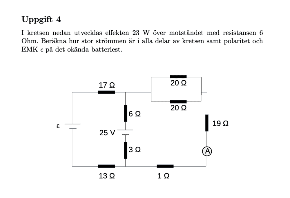

In the circuit below, the output is 23 W across the resistor with the resistance 6 Ohm. Calculate the amount of current in all parts of the circuit as well as the polarity and EMF ε of the unknown battery.

Circuit:

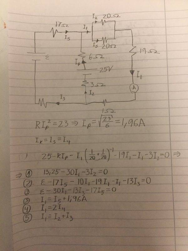

My attempt:
I get 6 unknowns with 5 equations. I don't know how to find the last equation.
Thanks in beforehand!
I don't understand your notation: what is ##I_K## ? Where is ##I_4## ?
Ah, I see. And where is ##I_P## in the equations ? Only in the 13.25 ?
You make things difficult for yourself by not first simplifying the circuit. It can easily be reduced to three resistors and the two voltage sources.

Yes ##I_P## is only in 13.25, I wrote the numerical value directly instead of the symbol ##I_P##. I know I can reduce the ressistors to one equivalent ressistor in the part of the circuit where the current is ##I_0## but I already did that in equation 1. How do i reduce the circuit to an equivalent circuit with three resistors and the two voltage sources? How would you solve this? I know I can reduce the part where the current ##I_0## goes in the circuit but I did that in equation 1.

What about the difference between ##I_P## and ##I_2## ? Would that be your missing eqn ?

One in the left branch, one in the right branch and one in the middle branch :smile: !
Also makes you understand there are three relevant currents, not 8 or 9

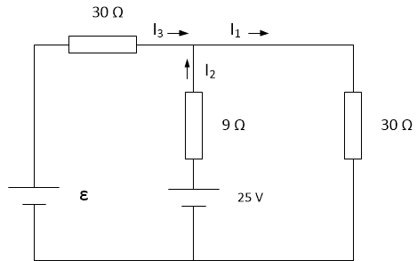

So you mean ##I_5## = ##I_3## and ##I_P## = ##I_2##? Can you show that please? And thanks for everything!
These follow from the definition of an ideal battery: it provides zero resistance at fixed potential difference.

current is charge flow. If the currents on the two ends of a battery would not be the same magnitude, the charge accumulation would quickly be enormous ! And with it the electrostatic energy. Compare with a water pump: what goes in must come out or the pump explodes (or implodes)

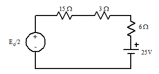

Bit of a nasty question. Just a casual perusal of the circuit let's one know that the constraint of 23 W dissipated by the 6 Ohm resistor could have current flowing in either direction. So there will be two solutions for the battery emf, one positive, one negative (for your chosen emf direction).
If we find the emf (or rather both emf's) then finding the rest of the currents should be rather straight forward.

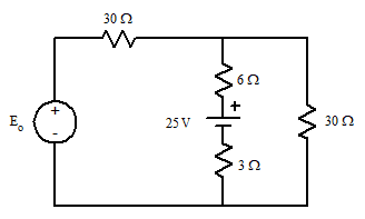

Start by consolidating resistances other than the one 6 Ohm resistor in order to simplify the circuit:
Essentially the left branch and right branch resistors have been assimilated into single resistances.
We can see that the two 30 Ohm resistors form a voltage divider with E0. So plop that in and re-draw the circuit:
From here you should be able to find the *two* values of Eo that will result in a 23 W dissipation by the 6 Ohm resistor. Once you have that, the rest follows from Kirchhoff.
Okay, I don't know if the Problem Originator intended for there to be multiple solutions to the problem, perhaps he/she intended only that the positive value for Eo be considered.

With respect, I find this dangerous and prefer a more straightforward approach, starting from the first layout. With the symbols and notation as in post #1:
I2 is known (except for the sign, as Karl -- and I o:) -- misssed).
Postpone the ##\pm##; we have three unknowns: two currents and ##\varepsilon##.
And we have three equations: One simple Krichoff and two Ohm.
As for the sign: Two outcomes, one or both positive for ##\varepsilon##. the original circuit shows ##\varepsilon > 0## so maybe one can be written off.
Too lazy to do the math -- helper prerogative -- it's not my exercise anyway :cool: .
It's just a dash of Thevenin. Nothing to be wary of.
