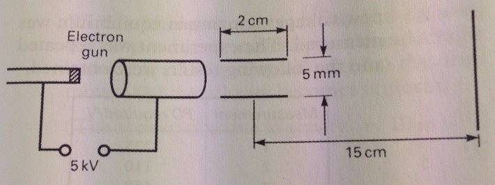

Calculate the deflection sensitivity in mm per volt
In summary, the charge/mass ratio of the electron has been determined by calculating the deflection sensitivity of a cathode ray tube using various data such as the potential difference, length and separation of deflector plates, and distance from the screen. The energy of the electrons can be found by using the formula E = V/d, and their initial velocity can be calculated using the formula v = √(2eV/m).
moenste
711
Describe a method by which the charge / mass ratio e / m of the electron has been determined.
Calculate the deflection sensitivity (deflection of spot in mm per volt potential difference) of a cathode ray tube from the following data: electrons are accelerated by a potential difference of 5.0 kV between cathode and annode; length of deflector plates = 2.0 cm; separation of deflector plates = 5.0 mm; distance of mid point of deflector plates from screen = 15.0 cm.
Answer: 6 * 10-2 mm V-1.
2. The attempt at a solution
I found E = V / d = 5000 / 0.005 = 1 000 000 V and that's it. Not much clear or basic information on the deflection of spot in mm / V can be found online. And I don't think it's as easy as 5 mm / 5000 V.
The 5 kV are between the cylindrical shell and the electron source. There is no voltage given for the two plates to the right.
What is the energy of the electrons once they reach the cylindrical shell? What is their speed? How long will they be between the two parallel plates?

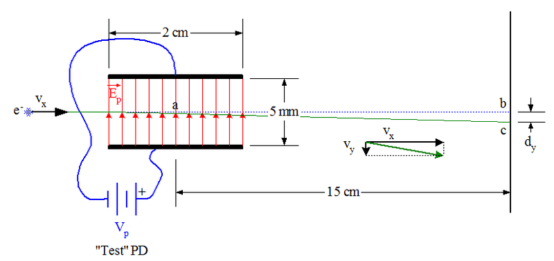

We then have a voltage VP between the plates, like this?
mfb said:
Yes.
I can only think of finding E. E = VP / d.
Okay.
The electrons fly horizontally into the gap between the plates. There they are in an electric field in vertical direction. What happens (first in words, then in formulas)?
Likes moenste
mfb said:
Okay.
The electric field between the two plates is going in some vertical direction and the electrons deviate from their horizontal movement towards some plate. I don't know why. Maybe because the electric field creates a force which affects the electrons and so they deviate.
moenste, you've done at least one other problem where an electric field between two parallel plates deflected the charged particle moving between them. This shouldn't be a new concept for you. Perhaps you need to review Coulomb's Law and electric fields?

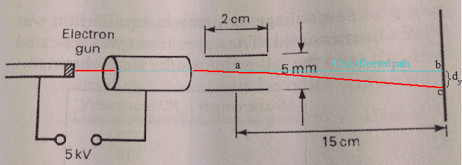

We have PD VP between the plates. We have distance d. We find the electric field E = VP / d.
We have original velocity v = √ 2 e V / m and we have time to pass the two plates t = 4 d / v.
What do we need to find? The angle of deflection? Why is the angle in mm V-1 and not degrees? What mm do represent here? 20 mm, 5 mm or 1500 mm? Voltage is VP?
The sensitivity of the device has been defined for you to be the linear deflection in mm per volt of PD applied on the deflection plates. They could have defined it to be "degrees per volt" but they didn't. The deflection in mm is more practical for such a device, because it can be measured on the screen (think of a CRT screen).
You want to determine how much the electron is deflected (in mm) for every volt applied as Vp. That's why Vp was not specified as a particular value. The deflection in mm is measured on the target screen, and it's the distance from the horizontal (undeflected) path to the impact point when the potential Vp is applied.
If you can find the deflection angle then you can work out the deflection by geometry. I'd suggest using the horizontal and vertical speeds of the electron as they leave the plates (i.e. the "launch velocity components") as the basis for determining the deflection angle, and using similar triangles rather than trigonometry to find the deflection distance on the screen.

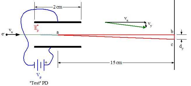

Here's a diagram depicting the part of the problem you're working on now:
Likes moenste
We have vx = √ 2 e V / m.
vy: e (VP / d) = B e vy → vy = VP / B d.
Then we find angle: tan θ = vy / vx = [VP / B d] / [√ 2 e V / m].
Where did B come from? What's it's value?
Likes moenste
  • #31
Maybe then vy = d / t?
  • #32
You're just guessing. What force is acting on the electron? What's the acceleration? How long does the acceleration last? What's the resulting speed?
You need to be able to identify the salient details of a scenario, identify the forces acting, and write equations for them. Throwing random equations at the problem won't yield the desired results.
Likes moenste
  • #33
I can only think of electric force E.
v = u + a t
a = F / m = e E / m, u = 0
v = (e / m) E t.
But that's wrong, as you earlier said.
So I've no idea what else is applicable here.
  • #34
v = u + a t
v = (e / m) E t.
It was wrong before because you were using the wrong potential difference to set the electric field. Remember, you plugged in 5 kV for the potential difference on the plates when that potential difference isn't associated with the plates at all. It just happened to be a handy voltage that was mentioned in the problem...
This time you've agreed that the plate potential difference is the "test value " Vp. That is a correct approach. Write E in your equations above using Vp and the plate geometry and you're on the right track.
Likes moenste
  • #35
Alright, so now we have:
vx = √ 2 e V / m.
vy = e VP t / m d.
Then we find angle: tan θ = vy / vx = [e VP t / m d] / [√ 2 e V / m].
