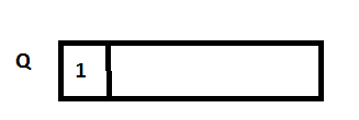

I wanted to implement now the Breadth-first search,with the node $(1)$ as node $(s)$.
At the beginning,we have:
and then:
But..then, does the queue remain empty,because of the fact that the node $1$ has no children or is it: $Adj(1)=\{ 3 \}$ ? (Thinking)

With the edges directed as they are, you are quite right.
Good! (Smile)
So, to make the example more interesting, let's pretend that all those directional edges are really bidirectional edges.
What would you get then? (Wondering)

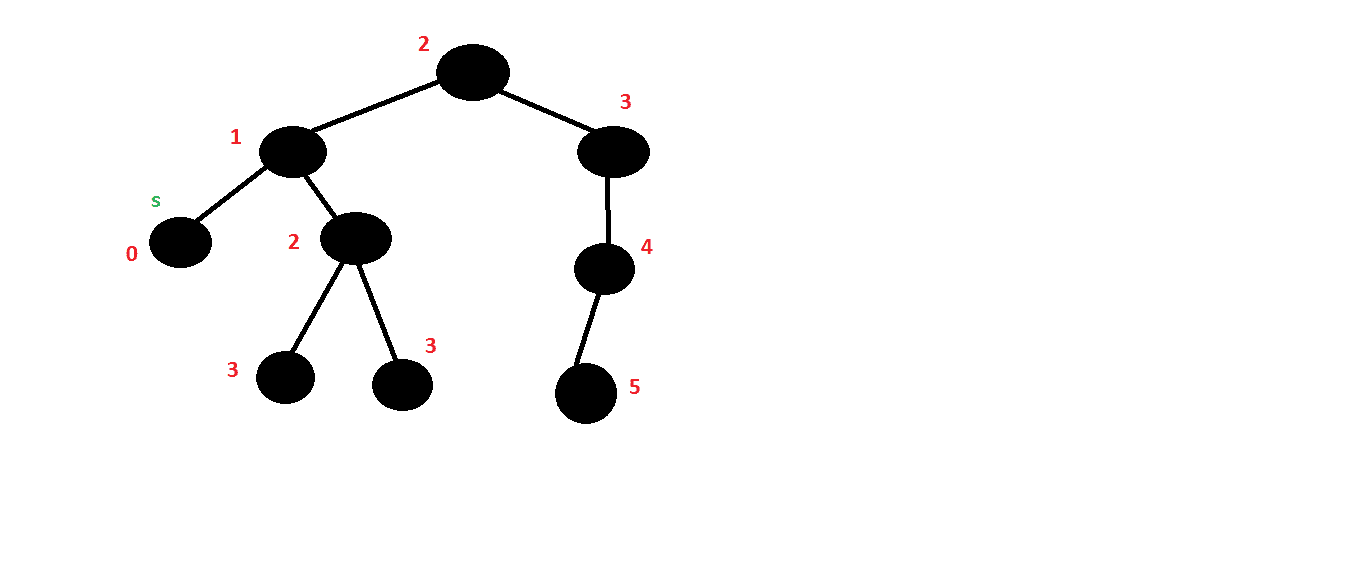

Picking $(1)$ as node $s$,I got the following:
So, $u=13$ and $\delta(s,u)=5$
Then,picking $(13)$ as node $s$,I got:
So,the diameter is equal to $6$,since this is the length of the longest path that exists at the tree,right? (Thinking)

Right! (Smile)
Actually, in the 2nd step, you shouldn't have picked (13) as $s$.
It is still called $u$ and you're supposed to find $w$.
