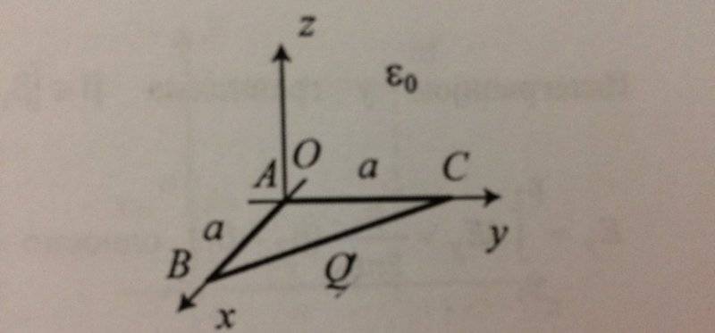

Find the expression for the electric field at point M(a,a,0) if the linear charge density is known ( ##Q'## )
3. The Attempt at a Solution [/B]

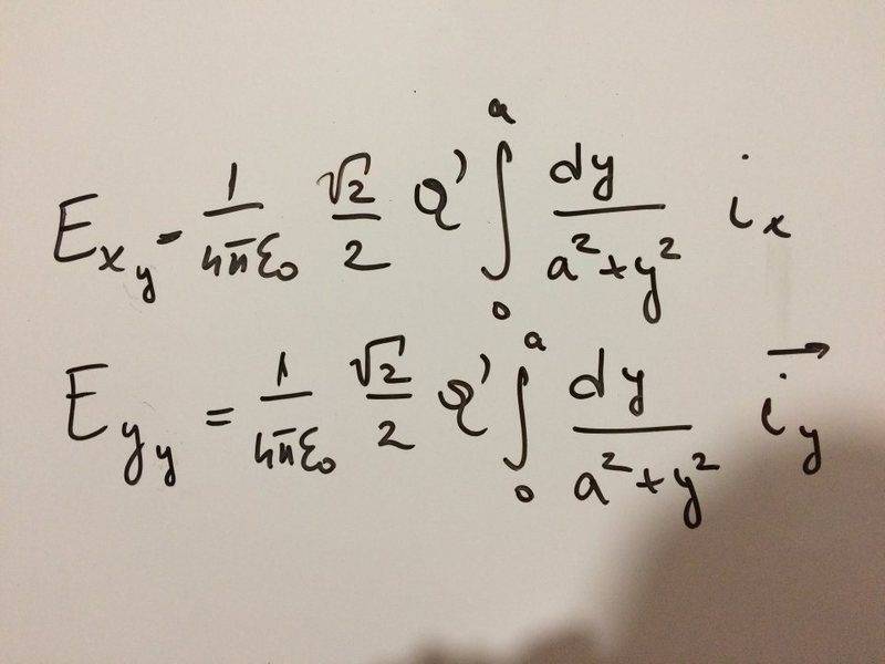

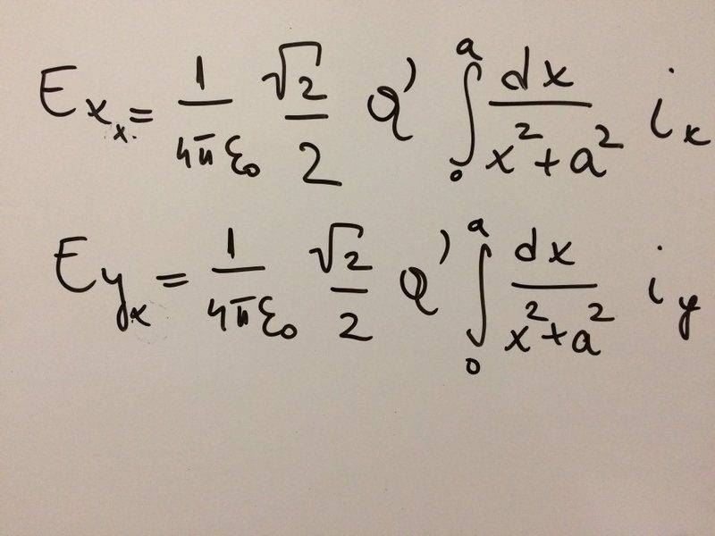

I tried something like this and would like your feedback on it. I separated the triangle into three parts. First i consider only the side on the x-axis and calculate that field.
##E_x=E_{Xx}i_x + E_{Yx}i_y## I hope the notation is clear because i use ##E_x## as the total electric field of a x segment of the triangle and the ##E_{Xx}, E_{Yx}## as the vector compositions of the mention vector. Since its a square they are each ##E_x\frac{\sqrt{2}}{2}##. The same i wrote for the ##E_y## segment as that segment only adds on the vectors on the x segment but are integrated by ##dy## (see the picture). Does this make sense and is it worthwhile to continue adding the third segment, which will have to be integrated by ##dy## and ##dx##? I think i could do tCould you help me with this, it has been struggling with me for a while now xD..
Where is M? You wrote (a, a, 0), but as it is not shown in the diagram I'd like you to confirm that.
I do not understand how you get your integrands. What is the magnitude of the field at M due to an element dx at distance x from O on the X axis? What are the X and Y components of that?
The M is not shown but i confirm that that is the point where electric field is to be calculated. I can explain what i did like this:
Consider only the x-axis and the point. The Electric field do the element ##dx## is ##dE=\frac{Q'dx}{4πεr^2}##, ##r^2=a^2+x^2## and ##r## is the distance from some point on x-axis to point M. The total electric field is the integral of all elements ##dE## from ##x=0## to ##x=a##. The components of this vector are acting in x and y directions and are both equal in magnitude ##dE_x=dE_y=dEcos45=dE\frac{\sqrt{2}}{2}##
diredragon said:
The total electric field is the integral of all elements dE from x=0 to x=a.
Yes, but that is integrating a vector. The fields from the dx elements do not all point in the same direction. You need to break it into components before integrating.

I thought that was what i did in the pictures i posted.. broke the electric field vector from the x segment into its components, the x and y of that vector? They are the same in magnitude as i wrote but point in different directions as indicated by ix and iy unit vectors..right?

No, you seem to have integrated wrt x before breaking it into components. That is not valid because you integrated a vector as though the direction was constant. The field due to each little dx points in a different direction.
The magnitude of the field at M from an element dx at distance x from B is ##\frac{kQ'dx}{a^2+x^2}##. What direction is it in? What are its X and Y components?

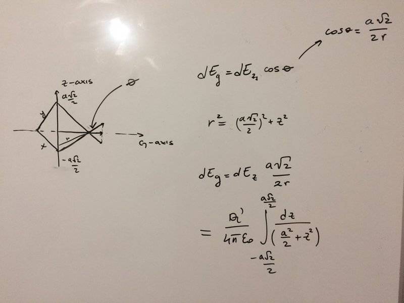

I ment ##\frac{a\sqrt{2}}{2}## to be the distance and i think it would be easy to transit from z to original. If i place the line along z axis and imagine that the normal to z is some G axis i get the electric field only aling that G couse the Z component cancels out. Imagining that it should be that ##(E_g)^2=(E_x)^2 + (E_y)^2## (components of the z line segment ) where the components are the same because of the fact that the point is at middle from the line. Then they are each in positive respective original axis direction and equal to the product of the magnitude of ##E_g##, ##cos(45)## and respective unit vector..##i_x, i_y##. This seems correct, what do you think?
Not sure I followed all that. Just post your working, that will be clearer.

I used a lot of symbols so ask if something need clearing up. Basically this would calculate the resulatant electric field generated by the third line in the coordinates that were made up. If this is correct all i need to do now is transit the third vector to the original coordinates and add up its components where they need to be added up.
Again, you appear to have integrated the magnitude of the field (##\int \frac{dz}{c^2+z^2}##) instead of its components. All your integrals should be of the form ##\int\frac{cdz}{(c^2+z^2)^\frac 32}## or ##\int\frac{zdz}{(c^2+z^2)^\frac 32}##, according to whether the component is normal to the wire segment or parallel to it.
I posted it above but missed to put in in the formula, the term missing in the integral is ##\frac{a\sqrt{2}}{2r}## and this should be the right form?
