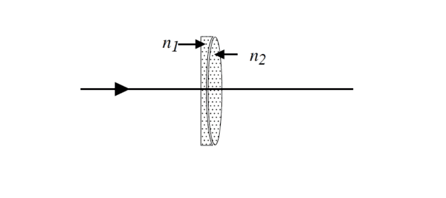

The picture below shows a so-called chromatic doublet, which is designed to minimize chromatic aberration, ie the wavelength dependence of the refractive index of the glass. The first lens has a flat first surface and a concave second surface with radius of curvature R and index of refraction n1 . The second lens is double convex with curvature radius R (refraction index n2) and sits close to the first lens. The lenses can be considered thin.
Calculate the focal distance of the duplicate
