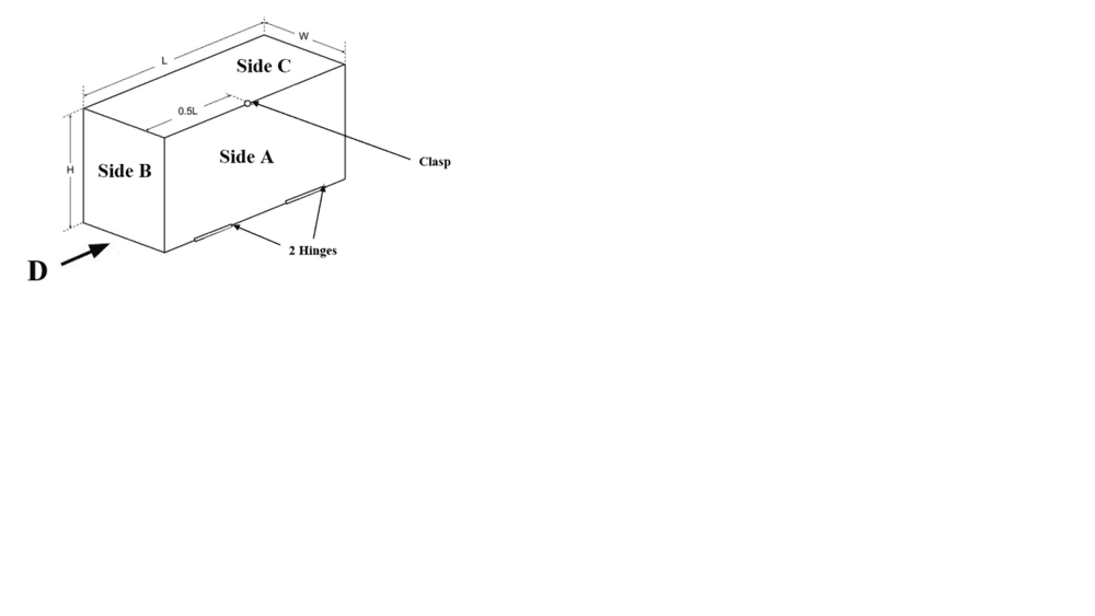

A hinged water storage is shown below. Its top side is denoted as C, the narrow side as B and the long side as A. Assume water density is 1000 kg/m3 and gravity is 9.81 m/s2
Side A is hinged at the bottom edge and secured using a clasp at its top edge.
Dimensions are: L = 1m, H = 0.5m & W = 0.5m
a) Calculate the size and location of the water thrust force on side A

picture of the box

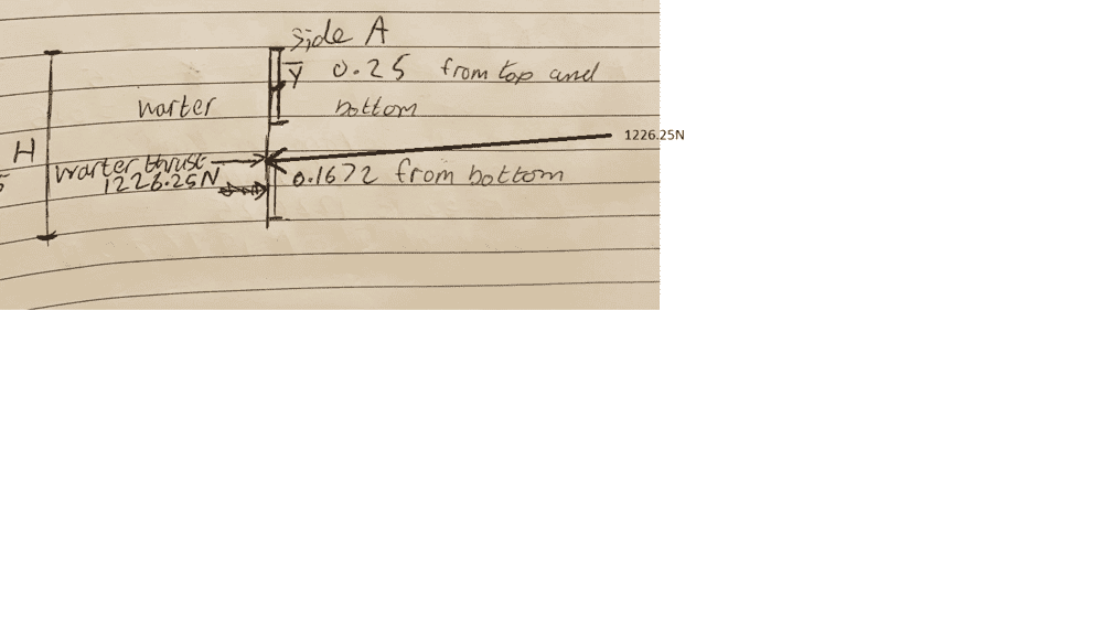

Draw a side on view of side A (looking along arrow D shown) and show the size of the two forces acting on the tank side and how high they are located from the bottom of the tank
Calculate the required resisting force at the clasp to keep the panel shut.
my working out for all 3 questions are their i am just unsure what the other force would be on the side of the box
It can't just be the force of water pressure. There must be a combination of forces to achieve equilibrium. There's the force of the clasp, but that is at the top, so there'd still be a net torque. With just those two forces, which way would the panel rotate? What prevents that?

so with using a side view like the question says i will only have to do a load at the top and bottom? What method would i need to use to find out what the loads are? or since its a 3rd of the way up would i need to 1226.25/3=408.75 for the bottom and 1226.25-408.75=817.5 for the top?
or do you think that it would be suffice just leaving it like the image that i have posted up?
Thanks.
Along the right lines, but not quite.
Take moments about some point. Any point will do, but some will make it simpler than others.
