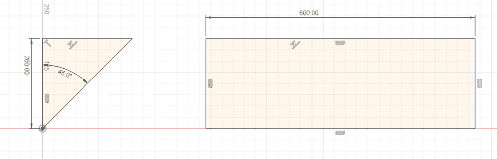

I have been tasked with building a wave generator in a flume. I need to find out how much force will be required to drive a wedge into a body of water so that we can get the right sized motor. For simplicity sake this wedge is 200mm tall, with a 45deg angle and 600mm wide. It is entering the water at a rate of 400mm/s and travels to a maximum of 200mm deep, or all the way. I realize the amount of force will change the deeper in it gets, but we are interested in the maximum force required to push it down at this speed. Any help is greatly appreciated. Proper formulas would be helpful so we can readjust things if dimensions change.

The flume is quite long, roughly 10m and we will be building an inclined plane on the far end to dampen out the waves so there is no return reflection.
We could pre-weight the wedge although I was going to assume no weight (essentially buoyant) and just seek the total amount of force required to push it down. I don't remember enough about physics to remember if its a 1:1 ratio for adding extra mass to the wedge (ie if it takes 100kg of force to drive the wedge down that fast and the wedge weighs 10kg, then I would need 90kg of down force). The one problem with weighing it down is I need to pull the wedge up at the same speed so there needs to be a balance.
I guess I don't quite know what accuracy we need. Probably close counts. If we are targetting 200mm/s and it ends up at 185mm/s I am sure its fine and we can measure that and calibrate it from there.
