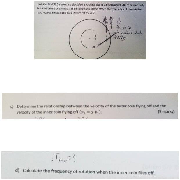

Hi. I have tried and tried and I just can't figure this one out. I'm assuming the outer coin flies off first, then the inner coin. I'm assuming for that to happen, the rotation frequency must be higher (or do both coins come off at the same time or the inner coin before, with the inner coin not needing to have as high a velocity?) I believe the relationship between the velocities is v_outer = 4v_inner. I am not sure how to get the frequency for the inner coin (I have working out for different ideas but it's quite a mess so I won't include it here, but my thought process is expressed above) Any help will be greatly appreciated. Thanks!

The last sentence in the posted screenshot of the statement of the problem says "When the frequency of the rotation reaches 3.00 Hz the outer coin (2) flies off the disk." Physical reasoning aside, it is fair to assume that the coin mentioned is the one that slides first because it provides the data for predicting when the second coin will slide.
Providing the rotation rate at which the inner coin flies off would also work, so the text is not definitive.
But I was hoping to elicit some physical reasoning.
