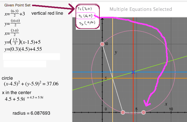

1. Homework Statement
A circle in a x-y coordinate system is given. The equation of the circle is unknown. The circle touches the x axes at (3,0). It also passes through the point B (0,10). Calculate the length of the circle radius?
(x-p)^2 + (y-q)^2 = r^2
[/B]

When I did this problem in January, I used the numbers from the OP's doodle.
Unfortunately, they included an erroneous point: T2 (6,0)
I didn't catch the fact that it was a bogus number until I had finished the problem and arrived at the incorrect answer.
But I was able to determine my methodology from the order of the equations, and come up with the correct answer.
Unfortunately, we aren't allowed to simply give you the solution, so I'll provide one correct way to get the wrong answer:
246383
I have fairly high confidence that this is the correct answer when the extra point, (6,0), is added to the problem.
It's basically the method recommended by neilparker62 in post #9.
The only thing I had to google was the fact that; A line perpendicular to another has a slope that is the negative reciprocal of the slope of the other line
I'm not a mathematician, so I don't know such things.

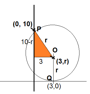

Here is the excellent figure given by my friend, @ehild .
The fact that the circle is tangent to the x-axis at (3, 0) is derived from the information in the problem statement indicating that the circle "touches" the x-axis at (3, 0) . This is in contrast to the wording for the other given point: "It also passes through the point B (0,10)."
chwala said:

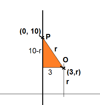

I don't understand how you use the points (3,r) and (0,10) and say that this is equal to r. What I have used is Pythagora's theorem where ##adj^2+opp^2=hyp^2 ##and my hypotenuse is L. Unless am not seeing your view, enlighten me...
Using @ehild's figure for the filled in right triangle we have:
One leg of the triangle has length of (10 − r). The length of the other leg is 3 units. Choose one of these as adj, the other as opp .
The hypotenuse, of course, has length of r .
You then find the solution by solving the following equation for r.
## (10 - r)^2 + 3^2 = r^2 ##
WolframAlpha gives the following graph when the resulting solution for r is plugged into the equation for a circle centered at (3, r) having a radius of length, r.
