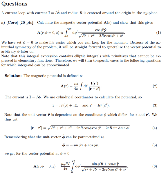

Can someone explain what exactly happens at (4) ? I do not clearly follow, except that there is some cosine law going on?
I also do not really understand why at (3), r' doesnt have a z hat component, but I can live with that.
You need to realize that the current I(r') is nonzero on a loop in the xy plane at radius R. This limits the integration and provides symmetry.
Likes casparov

I thought it was due to symmetry, just a bit confused why we keep it in the unprimed, but I guess it is part of the definition of the vector in cylindrical system.
Can you please be able to explain how step 4 is achieved ?

Then write out the denominator as a dot product.
But it is not really a dot product is it ?
If I do that then, I get just the cosines right, and not the sines part also then ?
I guess my confusion lies at this position vector stuff, I really do not grasp it well.

The magnitude of a vector is the square root of the dot product of the vector with itself, so you have
$$\lvert \mathbf{r}-\mathbf{r'}| = \sqrt{(\mathbf{r}-\mathbf{r'})\cdot (\mathbf{r}-\mathbf{r'})}$$

Thank you very much for the reminder
Hi @casparov. It might be worth noting an alternative (but less elegant) approach - use Cartesian coordinates:
##\mathbf{r}= <r \cos \phi, r \sin \phi, z>##
##\mathbf{r’}= <R\cos \phi’, R \sin \phi’, 0>##
##| \mathbf{r}-\mathbf{r'}|^2 = (r \cos \phi - R\cos \phi’)^2 + (r \sin \phi - R\sin \phi’)^2 + (z - 0)^2##
which easily simplifies to equation (4).
In some situations, using Cartesian coordinates might be a convenient choice.
