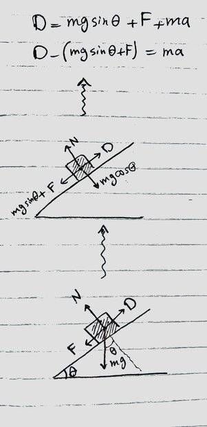

Likes MatinSAR, chwala and SammyS

I agree with final answer but do you know what ##F_0## is?
If you ask me It is better to use post #4 to identify net force acting on car in terms of ##D## and ##F## and ##mg##.

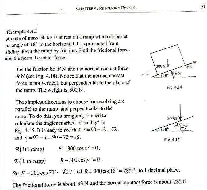

That should be the vertical force i.e acting perpendiculor to the road. ...let me check on this ..what i have on my textbook notes is a bit confusing...see the attachment ...
But what causes this force? It's interesting that your book doesn't mention it! Look at digram in post #4. It's the gravitational force.
In your solution ##F_0=mgsin \theta ##.

mg has 2 components. One perpendicular to the surface and one parallel to the surface.
##mgcos 72 ## is one of the components.
I can have my equation as,
##D= R+F+ma##
and noting that
##[ \cos 78^0 = \sin 12^0]##
then,
##D= mg \cos 78^0 + 250+ 255 = 2272.25##N
chwala said:
I think in my book ##mg## is what they are calling ##N## and ##R-N=0## and ##N## using the right angle triangle is given by ##\cos 72^0 = \dfrac{N}{8500}##.
Do confirm again on this.
Your book doesn't use ##N##. It used ##R## to show the normal force.

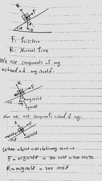

Let's solve the problems one by one. For question in post #7:
If there is any problem I'll be happy to help

I guess you're answering question in post #1 now. Is everything clear with question in post #7?
What is ##R## in your solution? If it is the normal force then you are wrong. See post #8 and note that I've showed normal force using ## N## instead of ##R##.

This part is now clear; i was mixing up the two forces...now using my attachment in post ##7## as reference, it is clear that the force acting parallel to the ramp is given by:
Firstly, ##F=ma## since the crate is at rest then ##a=0##.
now
There are two opposing forces that will enable equilibrium, let me have them as,
##F_1 - F_0 =0## where ##F_1## is the frictional force. ##F_1## makes an angle ##θ## with the parallel direction ##F_0## where ##F_0## using pythagoras theorem is given by ##F_0=300 \cos 72^0## or ##F_0 = 300\sin 18^0##.
Similarly, the force acting perpendicularly to the ramp is given by:
##R -N=0## where ##R## is the Normal contact force and ##N## is the force acting perpendicularly to ramp,
##N=300 \cos 18^0## using the pythagoras theorem. From here the steps to solution are straightforward.
