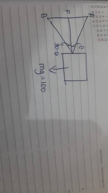

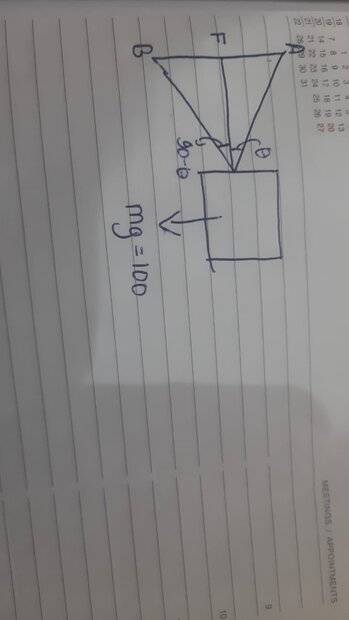

well I drew this diagram first
then for friction to be minimum I took b as my direction force acting on block
then wrote the equations
Fcosθ+N=mg------(1)
Fsinθ-friction of coefficient *N=ma-------(2)
now I don't know what to do after this

You need to put an arrow on forces in your diagram.
Do you think you should pull the block above the horizontal or below the horizontal?
I don't understand the point of A and B.
actually, ignore them
just think that te force applied on the block Is in the direction of B
Are you sure about that? You want to pull the block into the ground? Isn't that going to increase friction and make it harder to move?

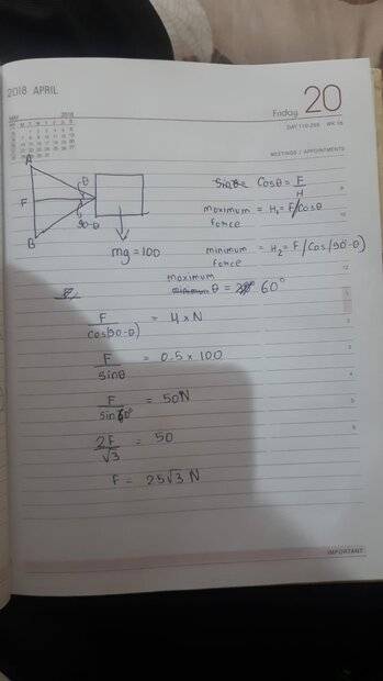

nailed it man
got the answer

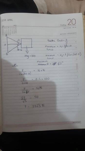

nailed it man
got the answer
I don't see how you got that answer, but it doesn't look right.
Generally, you need calculus to minimise something in a problem with a continuous variable.
