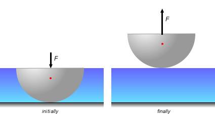

A hemisphere of 8 kg mass and 20 cm radius is at the bottom of a tank containing water. Find out the minimum work that an agent must to do to extract the hemisphere of the water.(g = 10 m/s2)

You're right rude man. Density of body < density of water. Initially the force F points down to keep submerged hemisphere.
I hope this image can help to unterstand better this problem.

The depth of water cannot be constant. I think you mean the hemisphere (i.e. half the sphere were it complete) is fully immersed.
The level of the surface of water is constant and at beginning the hemisphere whole is inside of the water.

To make the surface constant height we have to assume an infinitely wide reservoir. As the hemisphere rises, the space it occupied is filled with water. Where, in effect, does that water come from? (I'm asking for a specific height within the reservoir.)

You do need to assume that. If the level drops as the hemisphere rises then the buoyant force decreases faster.

Yes, but having raised the hemisphere a distance x, how much is still submerged? If the water level is constant it is 20cm-x, but if the tank has a finite extent the water level will have dropped and the submerged height will be less, reducing the buoyancy. As against that, it will not be necessary to raise the hemisphere 20cm to get it clear of the water. So it is not clear whether the work done will be more, the same or less. From a bit of algebra, looks to me like a falling water level requires more work to be done if, and only if, the density of the hemisphere exceeds half that of the water.

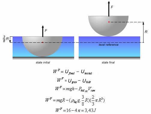

I've resolved thus. I've using a concept called "energy potencial of pression" which is equal to pression of center gravity of body multiply for volumen of the body.
Could you verify my calculation please.
I get the same answer by what is probably an equivalent method. Since the water level is constant, the water that flows into replace the hemisphere effectively comes from the surface of the reservoir. The average distance it falls in the process is 3R/8.
Thanks haruspex. Then we could say that the buoyant force is a "conservative force" and therefore we could associate to this a energy potential?
Yes, it's a conservative force.
