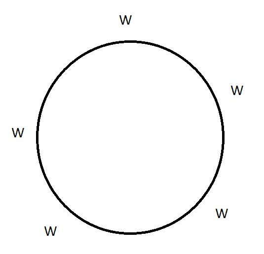

  2. $5$ women sit at a round table. $3$ men come later. With how many ways can the men sit between the women, if no man can sit next to an other man?

  2. We have the following:
    right?
    The first man has $5$ possibilities to sit between two women.
    The second man has $4$ possibilities to sit between two women.
    The third man has $3$ possibilities to sit between two women.
    Therefore, we get that there are $5\cdot 4\cdot 3$ ways so that the men sit between the women, if no man can sit next to an other man.
Is everything correct?
Yep. All correct. (Nod)
