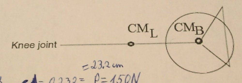

Thanks guys for the help, I'm good with the first one but now I'd really appreciate your feedback on this one.
Consider the following free body diagram. Using static analysis, solve for the muscle torque that will place this system in equilibrium, given mass of the leg and foot is 5.4kg; distance from the knee joint to the center of mass of the leg-foot system 0.232m; weight of the barbell 150N; and distance from the knee joint to the center of mass of the barbell 0.514m.
So we use the same formula once again. πΉπ‘š=(π‘ƒβˆ™π‘Ž+π‘Šβˆ™π‘)/c.
I believe P is 150N, a=51.4cm, c=23.2cm, W=5.4kg (52.7N). But how do I find b?
And then I have a formula for torque which is T=Fβ‹…r; r=distance from line of gravity. So I believe in my case r will be distance from the knee joint to the center of mass of the barbell (0.514m)?

I will if you post it.

Newby said:
c=23.2cm
No.
What force acts at 23.2cm from the joint?
haruspex said:
No.
Could you put me on the right track? I need to fully understand at least one of these tasks to be able to carry on by myself.
It's a simple enough question: what, according to the information given, is 23.2cm from the joint?
