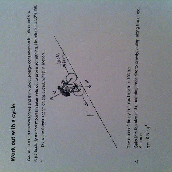

A cyclist attacks a 20% hill, the mass of the cyclist plus the bike is 100kg. Assuming g = 10 N kg^-1 , calculate the size of the retarding force due to gravity, acting along the slope.
g = 10 N kg^-1 , Work = Force x Displacement,
I was thinking that maybe resolving into vertical and horizontal components of the cyclists weight but am not quite sure how this would work. I have never worked a retarding force on a slope before. Some guidance please? Thanks
You have the right idea. Draw the free body diagram (FBD) for the cyclist. The weight of the cyclist points down toward the center of the Earth, and that will give you components parallel to the slope and perpendicular to the slope. The component parallel to the slope is the retarding force. If the slope is horizontal (0%), there will be no retarding force, and all of the weight is straight down. If the slope is 100% (45 degrees), how much of the rider's weight is the retarding force?

Please post your FBD for this problem.
There should be an image of it attached?

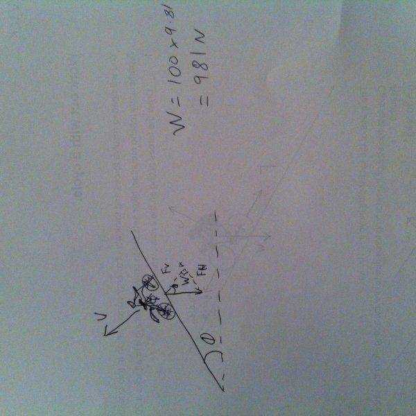

Ah, sorry. I missed that. So draw a horizontal line from the lower left point of the slope, and label that included angle θ. Now what?
Here is what I have came to so far. Not quite sure which trig function to use.
The gradient is 20% if that helps?
