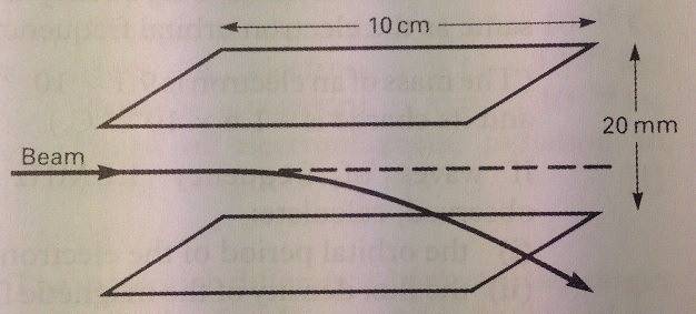

Two parallel metal sheets of length 10 cm are separated by 20 mm in a vacuum. A narrow beam of electrons enters symmetrically between them as shown.
When a PD of 1000 V is applied between the plates the electron beam just misses one of the plates as it emerges.
Calculate the speed of the electrons as they enter the gap. (Take the field between the plates to be uniform.)
(e / m = 1.8 * 1011 C kg-1.)
Answer: 6.7 * 107 m s-1.
2. The attempt at a solution
I used 0.5 m v2 = e E → v = √ 2 * (e / m) * E = √ 2 * (1.8 * 1011) * 1000 = 18 973 665.96 m s-1.
But this formula does not include the length of the plates and their separation. Not sure what to do next.

The situation in this problem is like when you throw a ball horizontally (parallel to ground) from top of a building and it hits the ground.
Which force is acting on the electron? In which direction?

Do you know how to calculate acceleration of an electron in an electric field?
Likes moenste
@moenste, As peroK has pointed out, gravitational pull will be negligible here. The electron is in an electric field. What is the force on the electron? In which direction? Which component of its velocity will be affected by this force? We have discussed a similar problem in another thread recently.

a = E e / m = (1.8 * 1011) * 1000 = 1.8 * 1014 m s-2.
F = e E in an electric field. On the picture they are moving downwards, so downwards is directed the force?
moenste said:
a = E e / m = (1.8 * 1011) * 1000 = 1.8 * 1014 m s-2.F = e E in an electric field. On the picture they are moving downwards, so downwards is directed the force?
Yes. The force is acting vertically downwards.
You know the acceleration of the electron. So which component of its velocity gets affected by this force? What can you say about the displacement of the electron?

Right. So there is a force in the vertical direction and there is no force in the horizontal direction. What does this tell you about the horizontal component of its velocity? Also, what are the displacements of the electron in vertical and horizontal directions?

the only force is due to the electric field which is at right angles to the 'horizontal' velocity.
You now know the time for the electron to 'fall' 10mm.
can you calculate the velocity of the electron to travel the length of the plates? (watch the units!)

There is. How do you think the electron undergoes horizontal displacement then? No force in the horizontal direction means horizontal velocity is constant throughout (Newton's first law).
moenste said:
x = v t
Right. You know the horizontal displacement and time. You can calculate the horizontal component of velocity using this equation.
This is the velocity of the electron while entering the gap.

E is the electric field, not the voltage. The potential difference between the plates is not the same thing as the electric field strength. You need to determine E first.

x is the horizontal displacement, not velocity. Use v=x/t.

Your units are volts divided by meters: V/m. (Or N/C, which amounts to the same thing)
Potential difference is specified in volts. The electric field is specified in volts per meter, or V/m.

You have the vertical acceleration and the distance traveled vertically while the electron is between the plates. How long does it take for the electron to travel that distance?

This might be a radical suggestion, but what if you did this algebraically, rather than plugging in all those numbers at the first opportunity? Maybe it's easier to keep track of a few symbols than all those numbers and maybe this means it's easier to manage the units?
You have the voltage ##V##, the distance between the plates ##d##, the length of the plates ##D = 5d## and the initial horizontal speed of the electron ##u##. And, of course, the charge ##q## and mass ##m## of the electron.
Perhaps you could shoot for the solution:
##u = 5 \sqrt{Vq/m}##
Then, as you know ##V## and ##q/m##, the numerical calculation is simple.

Check your value for s in line 3. The plate separation was given in mm, not cm.
I don't know what lines 4 through 6 were meant to accomplish. Line 3 was meant to find the transit time through the plates.
If you fix up the calculation in line 3 (and keep more figures in intermediate values! Don't truncate or round values in intermediate steps except for presentation purposes; never use rounded values to continue calculations) then you should be almost home and done.
You would also do well to heed what @PeroK said about using symbols rather than hastening to plug in numbers. Numbers are error sensitive, prone to typos, and it's easy to forget what they represent as you carry them through multiple steps. With symbols you always know exactly what you are dealing with.
Likes moenste
  • #31
1. E = V / d = 1000 / 0.02 = 50 000 V m-1.
2. a = E * (e / m) = 50 000 * 1.8 * 1011 = 9 * 1015 m s-2.
3. s = v t + 0.5 a t2, v = 0, s = 0.02 m → t = √ s / 0.5 a = √ 0.02 / 0.5 * 9 * 1015 = 2.108185107 * 10-9 s.
Now we have electric field E, acceleration a and time t: t = √ d / (0.5 (V / d) * (e / m)) → t = d √ 2 m / V e.
It gets the correct answer, but I have no idea how you derived it.
  • #32
You've used the whole plate separation for the distance in line 3. The electron only traverses half that!
Really, you should start using symbols. You'd have caught that right away.
Regarding the derivation of PeroK's result, if you did your work using symbols then it would just be a matter of simplification of the expression at the end.
Likes moenste
  • #33
Using symbols:
E = V / d
a = E * (e / m) = (V / d) * (e / m)
s = v t + (1 / 2) a t2 = v t + (1 / 2) (V / d) (e / m) t2
Doesn't look any easier.
  • #34
moenste said:
Using symbols:
E = V / d
This is for motion in the vertical, ##y##, direction, where ##v = 0## (initial velocity in the y-direction) and ##s = s_y##.
For what value of ##s_y## are you trying to find ##t##?
Likes moenste
  • #35
sy = v t + (1 / 2) a t2 = v t + (1 / 2) (V / d) (e / m) t2
Since v = 0 then: sy = (1 / 2) (V / d) (e / m) t2.
sy = 20 mm / 0.02 m.
