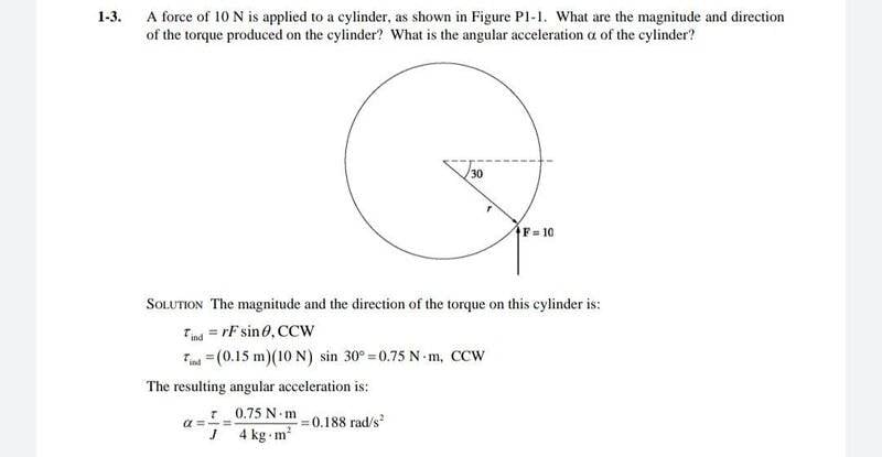

Calculate the torque that is produced by this force on a cylinder

Please take a look at the picture :
torque = r F sin(r, F)
Why it said that angle between r and F is 30?
I guess it should be 120 degrees... Am I wrong?
As far as I can see, the length of the arm of the force respect to the center of rotation should be ##rcos30##.
It didn't say that. The angle between two vectors is obtained by putting them tail-to-tail. If you do that with r and F, you will get an angle of 120°. Then note that ##rF\sin(120^{\circ})=rF\cancel{\sin}\cos(30^{\circ}).##

It didn't say that. The angle between two vectors is obtained by putting them tail-to-tail. If you do that with r and F, you will get an angle of 120°. Then note that ##rF\sin(120^{\circ})=rF\sin(30^{\circ}).##
You probably meant to write ##rF\sin(120^{\circ})=rF\cos(30^{\circ}).##
Yes, of course. Good catch.
So the book is wrong since sin30 isn't equal to sin120 degrees... @Lnewqban
