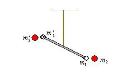

The torsion balance shown in the figure consists of a 40 cm long bar with lead balls with a diameter of 2 cm on each end. The rod is hanging by a 100 cm long silver thread with a diameter of 0.5 mm. When two bigger lead balls (density = 11.4 g/cm3) with a diameter of 30 cm are placed very close to each one of the balls, on opposite sides, their gravitational attraction tend to make the rod rotate in the same direction. What will the silver thread torsion be?
F=[/B]G.m1.m2/r^2
T=r.F
Shear modulus
The answer is θ = 0,00422º, but I don't know how to solve it.

Do you know how to determine the force on each ball? Do you know how to determine the moment of a force?
Yes, I know
OK. What is the sum of the moments caused by the gravitational forces on the rod?
Likes AlejandreBurgues908
I don't Know if this solution to your question is fine T=(2*0.2)G*m1*m2/(r1+r2)^2
Yes. Very nice. Now, if the system is in equilibrium, the string has to apply an equal and opposite torque to the rod. This torque is determined by the elastic properties and geometry of the string, and the amount that one end of the string rotates relative to the other end. For the analysis in your textbook on how to determine the angle of rotation, see Example 43 on pages 23-24.

Ok, now I understand the problem, the solution would be θ=2*T*L/(π*G*R^4) where T=(2*0.2)G*m1*m2/(r1+r2)^2 L is the lenght, R the radius and G the shear modulus, but how to calculate θ if the problem doesn't give me G?
You need to look up the young’s modulus and poisson ratio for silver, and use these to calculate G. The equation is given in your book.

Torsion in Spanish is also torsión, maybe Google translated to twist or something related, and isn't a real book, is just a PDF with some exercises that my teacher used as examples, the exercise 43 basically defines torsion but It doesn´t say the units.
Google translate to the rescue again!
If you look at Example 44 in the same paper you will see that "torsion" is sometimes used where "twist" would be used in English.
Also Example 44 shows how to calculate the twist (torsion) angle for a solid cylinder.
