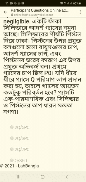

The top of an empty cylinder is covered with a piston. The forces applied to the piston are the atmospheric pressure, the ideal gas pressure, and the gravitational force applied to it due to the mass of the piston. At first the gas pressure was 0. If Q amount of heat is given to the gas slowly, how much will the volume of the gas change? The gas is one atom and the heat holding capacity of cylinders and pistons is negligible

Actually, they wanted to write that the pressure was P_0 at first. Then, they wrote if we use Q amount of heat slowly than, how much volume will change? (In your taken picture there wasn't "will change" word I took it from main picture).
TSny said:
(I assume that the phrase "the gas is one atom" means each molecule of the gas consists of one atom.)
The gas is mono-atomic. I just copy-and-pasted from google translate. That's why it is written `one atom`.
