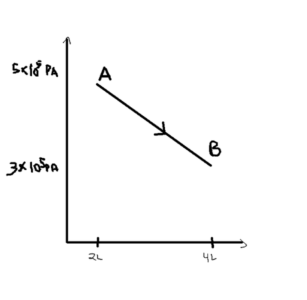

Calculate the work done according to the graph.
In summary, the task was to calculate the work done by a gas as it expands from point A to point B on the pV diagram shown. The equation used was Work=PΔV, and the attempt at a solution involved calculating the area under the curve and adding both areas together. The calculated answer was 8*10^11 J, but the correct answer was 800J. There may have been an error in converting units from liters to cubic meters.

Calculate the work done by a gas as it slowly expands from point A to point B on the pV diagram shown.
Work=PΔV
I calculatate the area under the curve and added both of the areas and I came up with 8*10^11 J and the answer sheet is saying 800J Now i really don't why I am getting the wrong asnwer if I'm doing everything step by step.

Hi ScienceGeek24! :smile:
(try using the X2 button just above the Reply box :wink:)
Your method is correct, but you seem to be saying that litre is 106 cubic metres. :biggrin:
