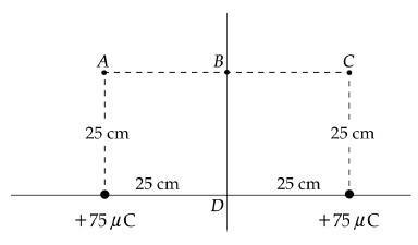

Calculate the work needed too move a 1.5μC test charge from point B to D.
Can someone just check if I'm thinking correctly?
Do I just use the formula:
W = qEd ?
For the E, I calculate the magnitude and direction of the electric field at B.
And I use 25cm for the distance and q = 1.5μC
W = qEd only works (pun?) if E is uniform. Instead, relate the work to electric potential or electric potential energy.
Ohhh, I see. So basically, the work needed to bring 1.5μC from a distance (25cm) away to a point 25cm from a charge 75μC?
Would it make sense to use this formula?
W = q(Va - Vb)
W = q[(k*Qa/ra) - (k*Qb/rb)]
q = 1.5μC
Qa = 75μC
Qb = 1.5μC
ra(75μC to D) = 25cm
rb(B to D) = 25cm
That's more like it. But, since the charge is being carried from B to D, you'll need to find the potential difference in going from B to D. How would you find the potential at point B due to the two 75 μC charges? Point D?
ohhh, righttt.
So, rewriting it ..
W = q(VD - VB)
VD = VD1 + VD2
VB = VB1 + VB2
where the distance for VD is 25cm
and the distance for VB is 35cm
Yes, Good!
oh, thank goodness lol! Thank youu!
