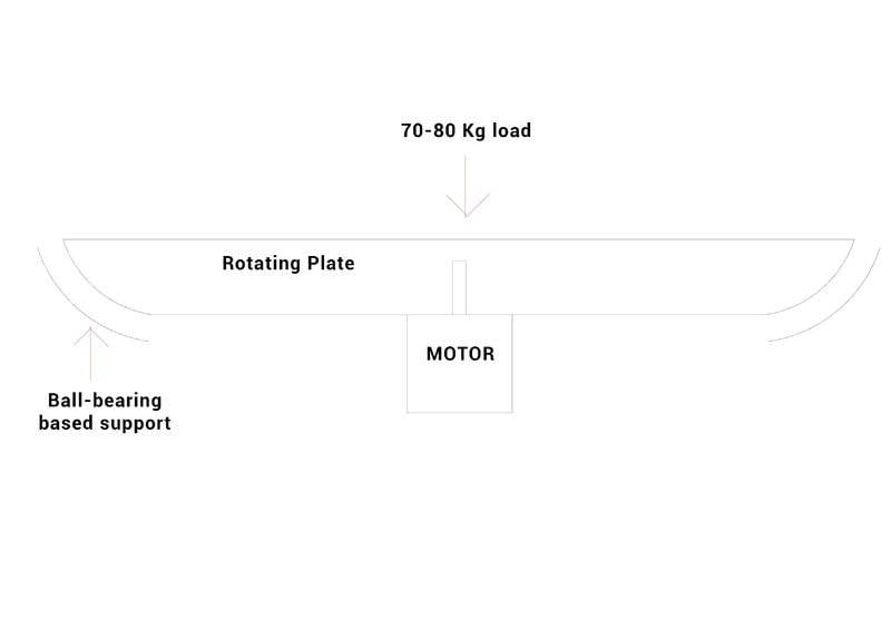

Hello,
I have a setup whereby:
1) A circular plate with fillet under-edge, is sitting like a bowl on some ball bearings. Imagine if you will a bowl sitting in a way that it can rotate and move a bit up and down etc. without much friction.
2) The plate needs to rotate at about 4 or 5 rpm.
3) The plate is 80kg.
4) The radius of the plate is 0.15m
5) A motor in the center spins it.
What I am trying to find out is the strength of a motor needed in order to rotate those 80kg continuously. Right now I am using a NEMA 17 planetary gear motor, which can only move a few kg and is hardly enough for what I need.
I calculated the following:
Angular velocity (w) = 0.166 rad/s
Angular acceleration (a) = 0.55 rad/s2
Linear velocity (at edge) (v) = 0.025 m/s
Rotational Inertia (i) = 0.9 kg*m2
So my questions are:
1) Are my calculations correct so far?
2) Given the formula of torque = i * a, does this mean just to multiply (0.9kg*m2) * (0.55rad/s2)?
In that case, I'm not sure I understand the units here... what is m2*rad/s2??
3) Eventually what I want to know as a result is the strength of the motor, meaning it's torque, in order for me to get a proper motor for this application.Thank you

Thanks! Okay so basically the torque is 0.5Nm, but this doesn't make sense when considering an 80kg weight.
The plate is turning via a motor shaft, and it's starting from 0 and reaching the Angular velocity (w) = 0.166 rad/s.
From what I understand, angular acceleration is the change of angular velocity over time, so I did (0.166rad/s) / (3s) which is an estimate of the time taking the system to "reach constant motion".
Could you help me understand how to make sense of this 0.5Nm figure I arrived at...?
If I understand you correctly, you are saying that you assumed a uniform acceleration over a 3 sec time interval to reach a speed w = 0.166 rad/s. The uniform acceleration is then alpha,
alpha = delta(w)/delta(t) = (0.166-0)/(3-0) = 0.0553333 rad/s^2
Then it looks like you applied T = I*alpha to get the torque,
T = (0.9) *(0.0553333) = 0.0498 N-m
(Looks like I disagree with you by a factor of 10 here.)
The big oversight seems to me to be that you neglected friction. You only calculated the torque required to accelerate the system, but with your model, it should spin freely forever once it reaches operating speed, without the need for any further input torque. It just will not work that way.
The assumption of constant acceleration is also somewhat dubious. Very few systems are capable of doing even close to this.
Also, where did the I = 0.9 kg-m^2 come from? Are you confident about this figure?

If your 80 kg object is a simple disk, then this is the correct MMOI formula. You described it as a bowl, and that suggests something other than a simple disk, but I have no clear idea of what your actual shape is.
As to friction, I cannot tell you very much without a much better understanding of your system. You have not given us a figure or any real details, so I'd simply be guessing in the dark.
Does this system start and stop regularly/frequently, or does it start up and run for a long time?
Hi,
Yes sorry - I'm attaching an image of the basic setup. The reason it is a "bowl" shape is because it's resting on inclined ball bearings, so basically the sides of the disk are curved to accommodate that function of 'resting' on the ball bearings. This is where friction comes in in a way.
The bowl rotates and should move around 80kg which are directly placed on top of it.
The system should optimally start and run for quite some time.
Does this help..?
Well, it helps in th e sense that nothing done above makes much sense now.
Most critically, just how that 80 kg is distributed will make all the difference in the world as to the value of the MMOI. Imagine two cases for a moment:
(1) the mass is all piled in a tall column with a very small base; it is essentially a slender rod located at the center of the bowl.
(2) the mass is all piled in a ring around the edge of the disk, with nothing in the center.
The MMOI for these two cases is radically different, and your 0.9 kg-m^2 value is utterly meaningless.
Now, regarding friction, I suggest you do some internet research on rolling element bearing friction. There is more too it than I can go into here.
In view of all the foregoing, don't you think it might be well to hire someone who knows how to do such things, rather than fumble through it yourself?
Once the plate has reached a steady rotational speed then its inertia is irrelevant to the power and torque required to rotate it. The only effect of its inertia once it is rotating is to reduce the amplitude of momentary rotational speed oscillations due to the drive system or outside forces. Only external forces, including the rolling bearing friction discussed above, are relevant.

Hi,
@Dr.D - the plate is 15cm in radius, and the weight on it would be a solid object, a cylinder, with 80kg in mass.
I'm broke, can't hire anyone :)
@JBA - The plate underside is indeed not completely smooth. This is part of what causes friction in the tests I made. The problem I am presenting is a simplified version of the mechanism in all of its detail because I am trying to figure out the simplest case possible.
In the case of the diagram I attached, given a bare minimum or no friction at all, what would be the strength of motor to move 80kg. That's all I'm trying to figure out. So the plate will ideally be rotating with a load on top of it, the diameter as mentioned, is 30cm.
In reality, the plate can 'move up and down' because it is in theory capable of being pushed gently to the sides, moving 1-2 cm and therefore moving 'up' the ball bearings that hold it (the ball bearings are on an inclined plane as in the diagram).
Right now the motor I am using is a NEMA 17 planetary gear, but it is hardly enough, it can barely move if you put 5kg on it.
Can you run a test to determine the maximum weight that can be applied and still have the plate rotate at your required rpm?
Also, can your plate be modified so to insure that your cylinder is absolutely and reliably centered on the rotating plate and is the cylinder uniformly round and of uniform density; and, its centerline perfectly perpendicular to its bottom face?
Yes I've run some tests, it's around 5kg max, maybe a bit less.
Regarding the centered cylinder - that's the theory that I am trying to figure out - can we assume that it is perfectly uniform etc and centered and calculate the motor for that?
Fit a radial bar temporarily and use a spring balance on the outer end to find how much force is needed to turn the plate at about the right speed and under the least favourable conditions of loading .
There seems to be little point to trying to size a motor for the best case (no friction) when you already know that friction is a major factor.
For the ideal system (no friction, no vertical motion) after the system is up to speed, no further torque is required to maintain speed because there is nothing else doing work on the system. But this is a meaningless case because you have said it does not really apply.
From my point of view, you have already determined an approximation for your required motor size. What is the power rating of your current motor?

Okay so I calculated it and the 'frictional moment' is around 2.5Nmm, which is 0.0025Nm.
I'm a bit lost. This is quite a negligible amount isn't it? How can this help me understand the total torque needed for the system...?
Please show me your calculations; and, what dimension did you use for the "bearing bore diameter" (it should be the inside diameter of the circle of balls in your case).
Yes sorry:
I think in the previous answer I made a x10 mistake again, but here is my new trial:
Let's say the plate+weight = 90kg, the ball bearing angle is 45.
So I calculated --> 90kg / 0.707 = 127.3 kg. That's the "equivalent dynamic load".
If I plug that into the second link you provided, I get:
M = 0.5 * 0.0024 (this is the ball bearing coefficient which they put in the table) * 1273N * 8mm = 12.22 Nmm --> which is equal to 0.01222 Nm
Are you saying that the inside diameter of your circle of bearing is only 8mm, that seems a very small diameter to me because I am under the impression that the bearings are located near the outer rim of your plate.
  • #31
From what I understand they meant "bearing bore diameter [mm]" to mean the size of the ball bearing right?
I have a collection of them positioned at 45deg, but each one has a diameter of 8mm, yes.
The entire plate is 300mm in diameter if that's what you mean.
  • #32
The correct d diameter is the diameter of the circle where your ball bearings run on the bottom of the plate.
  • #33
In that case it comes to about 430Nmm which is 0.43Nm
But that still doesn't make sense because the motor I'm using now is more powerful than that...
  • #34
Are your balls running dry or lubricated?
  • #35
What is the gear ratio of your planetary gearbox?
