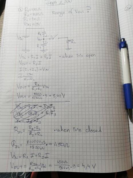

TL;DR Summary: I need to calculate Vout when the switch Is closed and open.
I need to calculate Vout when the switch Is closed and open. Is my work correct?
Edy56 said:
Is my work correct?
Yes.
I get 5.721 V and 4.405 V.
Likes Edy56
Baluncore said:
Yes.
Thank youu
