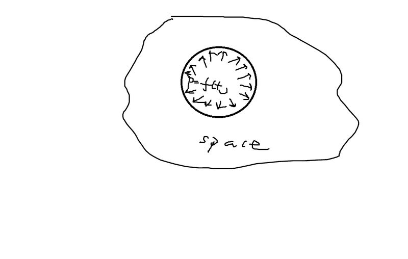

Hello,
Suppose I have a spherical hole in a elastic infinite space. I apply a time-dependent pressure to the inner surface of the spherical hole.
I know p = f(t).
If I only consider this as an elastic problem, no failure happened, how can I calculate the work done by p during the time from 0 to t0?

You could if you knew how the volume of the hole was changing over time. But all we know about the material around the hole is that it is "elastic" and "infinite". That is not enough to tell us how it deforms under pressure.

If the material is elastic, you need only consider the initial and final pressures. You can ignore the path taken between the end points, since work done may be recovered without loss due to plastic deformation or failure.
Do you know Young's modulus, E, for the material ?
The pressure on the spherical boundary causes an elastic deflection outwards. You will need to integrate the compression of the material from the sphere's radius to infinity. There are probably some simple approximations that can be made.
As measuring any internal parameter inside that elastic infinite space, perhaps the pressure and volume of the injected fluid could be more feasibly measured at the external source.

This is the spherical equivalent of applying a time varying force to the end of a semi-infinite rod. In this case, only radial displacements are present, but stresses are developed in all 3. principal directions (radial, latitudinal, and longitudinal). Still, this is a 1D problem in the radial direction. The local stresses are governed by the differential form Hooke's law in 3D. The stress-equilibrium equation in spherical coordinates should be employed, including the internal terms. You will end up with a wave equation in the radial direction. I recommend solving this first for a step change in pressure at the spherical surface. When that solution is in hand, you can represent the pressure as a series of step changes with time, and use superposition to get the time dependent solution (convolution).

The radial displacement is ##u(t,r)##. The nonzero components of the strain tensor are $$\epsilon_{rr}=
\frac{\partial u}{\partial r}$$and$$\epsilon_{\theta \theta}=\epsilon_{\phi \phi}=\frac{u}{r}$$
The non-zero components of the stress tensor are $$\sigma_{rr}=\lambda(\epsilon_{rr}+\epsilon_{\theta \theta}+\epsilon_{\phi \phi})+2\mu \epsilon_{rr}=\lambda\left(\frac{\partial u}{\partial r}+2\frac{u}{r}\right)+2\mu\frac{\partial u}{\partial r}$$
$$\sigma_{\theta \theta}=\lambda(\epsilon_{rr}+\epsilon_{\theta \theta}+\epsilon_{\phi \phi})+2\mu \epsilon_{\theta \theta}=\lambda\left(\frac{\partial u}{\partial r}+2\frac{u}{r}\right)+2\mu\frac{u}{r}$$
$$\sigma_{\phi \phi}=\lambda(\epsilon_{rr}+\epsilon_{\theta \theta}+\epsilon_{\phi \phi})+2\mu \epsilon_{\phi \phi}=\lambda\left(\frac{\partial u}{\partial r}+2\frac{u}{r}\right)+2\mu\frac{u}{r}$$where ##\lambda## and ##\mu## are the Lame' elastic constants.
The differential force balance in the radial direction for this symmetric situation reduces to: $$\rho\frac{\partial^2 u}{\partial t^2}=\frac{\partial \sigma_{rr}}{\partial r}+\frac{2\sigma_{rr}-\sigma_{\theta \theta}-\sigma_{\phi \phi}}{r}$$
If we substitute the equations for the stresses into the differential force balance of the previous post, we obtain $$\rho\frac{\partial ^2u}{\partial t^2}=(\lambda +2\mu)\frac{\partial}{\partial r}\left(\frac{1}{r^2}\frac{\partial(r^2u)}{\partial r}\right)$$or, equivalently, $$\rho\frac{\partial ^2\xi}{\partial t^2}=(\lambda +2\mu)r^2\frac{\partial}{\partial r}\left(\frac{1}{r^2}\frac{\partial\xi}{\partial r}\right)$$where ##\xi=r^2u##. At r = R, the boundary condition is $$\sigma_{rr}=\lambda\left(\frac{\partial u}{\partial r}+2\frac{u}{r}\right)+2\mu\frac{\partial u}{\partial r}=-P$$or, equivalently, $$(\lambda+2\mu)\frac{1}{r^2}\frac{\partial (r^2u)}{\partial r}-4\mu\frac{u}{r}=-P$$or$$(\lambda+2\mu)\frac{\partial \xi}{\partial r}-4\mu\frac{\xi}{R}=-PR^2$$
The boundary condition at large r is ##\xi=0##.
Initially the displacement is zero at all locations $$\xi(0,r)=0$$The initial velocity is also zero at all locations, except at the very boundary r = R (involving zero mass in the limit), where it is finite. From the solution for a sudden force applied to the end of a rod (at short times, the compression wave is very close to the boundary in our system, so that spherical curvature can be neglected at short times), we find that, for our case, $$\left(\frac{du}{dt}\right)_{t=0,r=R}=\frac{P}{\sqrt{\rho(\lambda+2\mu)}}$$or, equivalently, $$\left(\frac{d\xi}{dt}\right)_{t=0,r=R}=\frac{PR^2}{\sqrt{\rho(\lambda+2\mu)}}$$
This completes the formulation of the linearly elastic model equations for a suddenly pressurized spherical cavity.

It just occurred to me that there is a steady state (i.e., time-independent) solution to the equations I presented in the previous few posts that applies in the limit of vary gradually applied pressure (over time). This is analogous to applying a gradually varying compressive force on the two ends of an elastic rod. The steady state solution for the case of a pressurized elastic cavity is: $$u=\frac{PR^3}{4\mu r^2}$$and, at the cavity boundary $$u(R)=\frac{PR}{4\mu}$$Based on this, the work done by the pressure per unit area of cavity surface is $$w=\int{Pdu}=\frac{P^2R}{8\mu}$$Since the surface area of the cavity is ##4\pi R^2##, the total work done by the pressure is $$W=\frac{\pi P^2R^3}{2\mu}=\frac{(1+\nu)}{E}\pi P^2R^3$$where ##\nu## is the Poisson ratio and E is the Young's modulus.

Can you please show me more detail about how to get
from
I didn't get how to get $$du$$, I know how to get u(R)

I meant to write $$w=\int{Pdu(R)}=\int{P\frac{R}{4\mu}dP}=\frac{P^2R}{8\mu}$$

from 0 to ##PR/4\mu##
miraboreasu said:
and the integral is from where to where when dp?
from 0 to P

Now I finally get it, but what value I should use from p=f(t) to for the P in the work equation
$$P=f(t)$$
