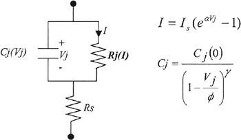

I really wanted to find the Y-parameter matrix of a Schottky diode working as mixer, whose model is this:
Should I conclude that it isn't posible to get it by adding capacitor Cj and resistor Rj Y-matrices, going to Z-parameters, adding the result with Rs Z-matrix, and finally going back to Y-parameters?
Thanks.
The Schottky is obviously part of a larger circuit - if you show us that then possibly we can advise you as to exploiting the conveniences of 2-terminal matrices, if any.
