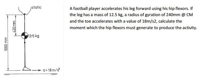

radius of gyration:
r = root (I/m)
I = moment of inertia
m = mass
parallel axis theorem given above
Okay, so I think the moment about CM is just m*0.24^2, but after that, I'm less sure.
Is the moment about the hip just m*0.42^2 + m*0.24^2?
If so, it's taking the acceleration and the distance to the toe into account that I'm having difficulty with. Is it just F = ma? If so, is the m taken from the moment of inertia at the hip, or the toe? I figure the distance to the toe must be significant, but I don't know how to account for it.
Any help?
Yes, you've got it.
How would you write the equivalent of F = ma for rotational motion?
Given the tangential acceleration, how would you find the angular acceleration?
Doc Al said:
Yes, you've got it.
Okay, maybe it's best to do the last two bits in reverse order;
if the tangential acceleration is 18m/s^2, and the radius is 1m, is the angular acceleration also 18 radians/s^2?
Then is the moment: angular acceleration * the moment about the hip?
And that's the final answer?
Right!
Right again.
Awesome,
thanks man, I really appreciate it.
