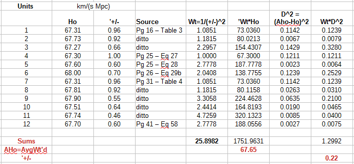

I used a spreadsheet (PNG image in main body section) to analyze 12 values with +/- error ranges which I assume for the purpose of this calculation to be standard deviation values. I am seeking conformation or corrections regarding the validity of the method I used.
Below is the spreadsheet image.
The source of the data in the two columns, Ho and +/-, is the following article
Let AHo be the conjoined weighted average values for Ho and the corresponding error ranges.
[1] AHo = AH +/- AE = 67.65 +/- 0.22.​
The Ho column contains the 12 values, Hi, for the Ho variable, i being the index (of a variable value) ranging from 1 to 12.
The +/- column contains for each Hi value the corresponding value of an error range, Ei, which I assume to be of 1 standard deviation σi.
The Source column specifies where in the article the particular 12 values for Hi and Ei are found.
The Wt=... column contains values, Wi, for the weights for calculating weighted sums. I assume that the appropriate choice of weight are the squares of the reciprocals of the Ei values.
[2] Wi = 1/Ei2
The sum of this column is
[3] ΣW = Σ[i=1 to 12] Wi = 25.8982 .​
The Wt*Ho column contains weighted Ho values
[4] WHi = Wi Hi.​
[5] ΣWH = Σ[i=1 to 12] WHi = 1751.9631 .​
The weighted average, AH, is
[6] AH = ΣWH / ΣW = 67.65.​
I feel confident that this result is OK for AH. I am less confident that my calculation below of AE is OK. I will present my analysis, and explain my main concern about AE, in what follows.
The D2^2=... column contains values, D2i, of the squares of the 12 differences between AH and a value of Ho.
[7] D2i = (Ho-Hi)2
Althought not part of the calculations, it will later be useful to also have defined the sum of the differences squared.
[8] ΣD2 = Σ[i=1 to 12] (D2i)​
The Wt*D2 column contains values, WD2i, of the product of a weight and a squared difference.​
[9] WD2i = Wi D2i
[10] ΣWD2 = Σ[i=1 to 12] (WD2i) = 1.2992​
I now define Aσ as square root of a quotient: the weighted sum of squared differences and the sum of weights. Using [3] and [10]
[11] Aσ = (WD2/ΣW)1/2 = 1.2992/25.8982 = 0.22​

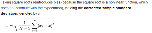

Ordinarily, since there are 12 samples I would expect
[15] Aσ = [(1/11) ΣD2]1/21/2.​
Equation [15] is based on the article
246207
I do not know how to adjust this for weighted samples.

You can directly calculate the second moments using the weights. Then use the usual formula for the variance as an expression involving the first two moments.
