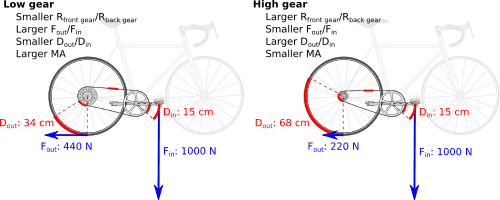

Also look here:
this picture is from https://en.wikipedia.org/wiki/Mechanical_advantage article
On Both bikes same force and power is applied on pedal,
the difference is gearing of the bikes. Bike on the left is making twice force/torque bike on right but on two times shorter distance which means two times smaller wheel speed.
Both bicycles encounter same acceleration. If i was using Newton's incorrect calculating of acceleration bike on left would have bigger acceleration. Also, i could have infinite acceleration with proper gearing...
How to calculate real acceleration? I can't just multiple force with distance or wheel velocity. What when the bike is stopped and i start to apply force on pedal? the wheel's speed and distance is 0 so would be the acceleration

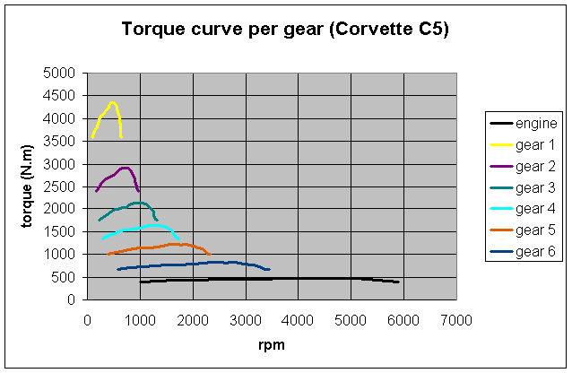

look at this too:
those are torques on wheel and rpm on wheels on different gears

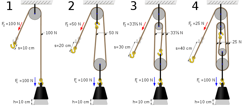

Look at this picture
its from https://en.wikipedia.org/wiki/Mechanical_advantage_device article
compare first and fourth pulley
the fourth have only 25N applied but its generating same force and acceleration as 100N in first pulley
I KNOW WORK and energy are same
but the fact is first and fourth pulley have different forces applied but same acceleration and power
but stupid Newton says that acceleration is DIRECTLY proportionally to force and inversely to mass
he haven't said a word about force over distance
i can't just multiple force with distance
because what if there is no distance at all?
for example imagine this pulley, let's say this weight on bottom is heavy and it stays on floor
now i apply force but this force is too small to overcome gravity
so there is no movement
BUT THE FORCE IS THERE

the fact is first and fourth pulley have different forces applied but same acceleration and power but stupid Newton says that acceleration is DIRECTLY proportionally to force and inversely to mass
Newton actually says...
http://en.wikipedia.org/wiki/Newton's_laws_of_motion
Second law: The acceleration of a body is directly proportional to, and in the same direction as, the net force acting on the body, and inversely proportional to its mass..
The force you refer to is not "acting on the body" being accelerated. In each case the force acting on the body is the same = 100N.

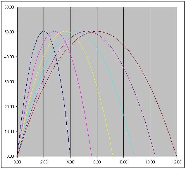

With an electric motor, torque decreases linearly as rpm increases. For the graph, torque = 3.2 (1 - rpm/600). As shown in the graph, power = torque x rpm x 2 x pi / 60. Power also equals force x speed, so force = power / speed = (torque x rpm x 2 x pi / 60) / v, where v is velocity. Assume bike's velocity is 2 m/s, then driven wheel force at 2 m/s versus rpm looks like:
Code:
  rpm  torque   power   force
    0   3.200   0.000   0.000
   50   2.933  15.359   7.679
  100   2.667  27.925  13.963
  150   2.400  37.699  18.850
  200   2.133  44.680  22.340
  250   1.867  48.869  24.435
  300   1.600  50.265  25.133
  350   1.333  48.869  24.435
  400   1.067  44.680  22.340
  450   0.800  37.699  18.850
  500   0.533  27.925  13.963
  550   0.267  15.359   7.679
  600   0.000   0.000   0.000
Note that the maximum force occurs at the rpm corresponding to peak power. To optimize the gearing, you'd want the center point between shifts to be near the power peak. With a continously variable transmission, you'd want the motor rpm to be kept constant at 300 rpm regardless of the bikes speed.
I agree that best power and ACCELERATION will be at 300 rpm.
But you can't equal force with power.
In your posted forces, at 0 rpm force is 0. So the car/bike would NEVER START MOVING. Which is not true.

Look at this picture i posted earlier:
those are torques and rotations of engine and wheel at each gear.
Now look back at bicycle:
The "engine" power is same in both bikes. Because of gearing, the bike on right is traveling 2 times faster that bike on left. But you see that force on wheel is different, and if you put both bikes on slippery surface, left one would wheelspin/crash when right one could still drive safely.
We can see that bike on right is "applying" force over 2 times distance left bike, whatever "applying force" means. Newton say that force is a force, dosen't matter distance/speed its making.
Wheel with axle is kind of machine with mechanical advantage https://en.wikipedia.org/wiki/Wheel_and_axle
so gearing convert between more/less torque and more/less speed
but what with acceleration? how to calculate it?

The engine is electrical and its maximum torque is at 0 rpm, on bigger rpm it has lower torque so power remains constant.
Look at the graph in the first post. The torque decreases linearly, and the power is at a maximum at 300 rpm, so the power versus rpm is not constant.

I made up some gear ratios for the motor shown in the first post to create a pair of graphs. The first graph shows driven wheel torque (or force if radius is 1 meter) versus speed for each gear, and the second graph shows driven wheel power versus speed for each gear. The ideal shift points occur where the lines cross (the lines cross at the same speeds in both graphs).
