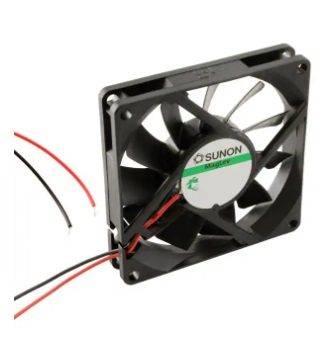

Does your axial fan look like this?

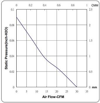

Because if it does, it probably has a fan curve something like this:
You can find the pressure loss in your tube by searching duct loss calculator. Here's one that looks good: https://www.engineeringtoolbox.com/duct-friction-pressure-loss-d_444.html. I plugged in 15 CFM, 1.5" diameter, and 4 feet long, and it said 0.1" w.c. pressure loss. That number sounds right to me.
If you have a size reduction at the beginning, add in the velocity pressure for the entrance loss. The velocity pressure for the same conditions is 0.09" w.c., and the total fan pressure needed is the sum of the velocity pressure and the duct friction loss. The total fan static pressure needed to push 15 CFM through your 1.5" duct is thus 0.1 + 0.09 = 0.19" w.c. If you want to measure these pressures, there is no need for a pressure gauge. Use a water manometer. A water manometer is a piece of clear plastic tubing, bent into a U-shape, and with some water in it. The pressure is the difference in water height between the two sides of the U, and is measured with a ruler.

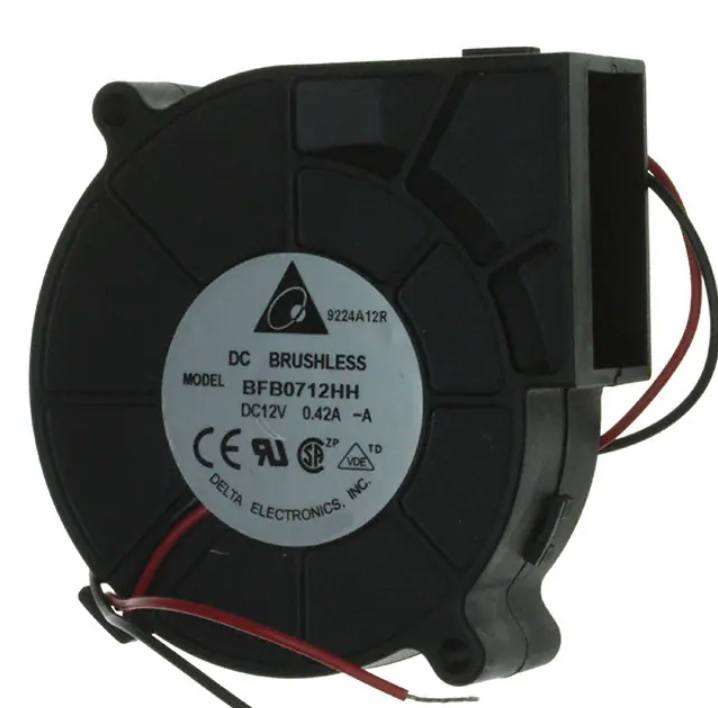

Here is a blower that would deliver 15 CFM through your 1.5" duct:
It was found in a quick search in Digikey. It is rated for 12 volts, draws 4 watts of power, and costs $18.00 plus shipping. Since the blower outlet is about the same size as your duct, the velocity pressure loss would be negligible, and you would need only a simple transition piece to connect it to the duct. There's more information in the datasheet: https://www.delta-fan.com/Download/Spec/BFB0712HH-A.pdf. It's not the only blower available, it's the first one I found in a quick search. Digikey is not the only supplier to check, Newark and Mouser may also have blowers.
