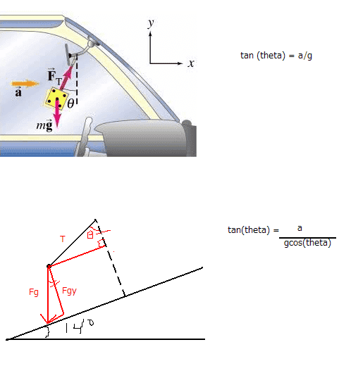

A sports car is accelerating at a rate of 4.23m/s^2 up a 14 degree hill. If there are dice hanging from its rear-view mirror, what angle will they swing on?
ƩF = ma
Kinematic Equations
Well, I'm thinking that I need to take into account the influence these two factors will have on the dice's angle (and the tension on the string that holds the dice):
1. Acceleration of the car
2. Force of gravity
I'm still working on a solid equation that encompasses the forces acting on the dice, so I don't want to post any unfinished math yet.
Any help or comments are very much welcome! :)
