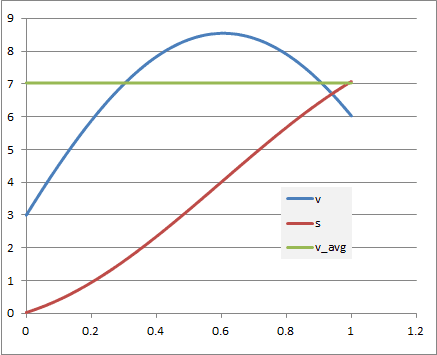

I do not understand why the solution divides by 2 if you use the average value formula in integration to find average speed. If you substitute in values between 0 and 1 then the speed never goes above 3 point something so average speed can not be 7.03 but why divide by 2?
Speed never goes below 3. Note that $$ 8\sin(2t)+3\cos(2t) = \sqrt{73} \; \sin (2t+\phi) \quad {\rm \ with \ \ } \cos\phi = {8\over \sqrt{73}} $$
The division by 2 is a mistake by the author of the book.
