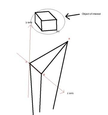

I was indeed thinking about 1 point (mapping landmark) at 3 different times to define an arc. For a bone that can rotate in several directions this is not a good idea, you will get false results.
It would be much better to identify as many landmark points as possible and then calculate the center of rotation, axis and angle from these (including some estimate of the error). I am sure that there more sophisticated and elaborate methods available in the literature than I can come up with here :-)
BTW, yasith, what kind of input data are you using?
this is a diagram to the problem
I have a perfect 3D volume rendered model of the wrist in 3D motion which I take measurements from
I have managed to map all the points of interest to a 3D coordinate system.
Therefore my input is p = [x,y,z].
The problem is to calculate instant axis of rotation. Therefore Vargo I can't assume the center of rotation will stay constant across point A -> B -> C.

Assuming you also don't know the center of rotation, I'd proceed this way:
  1. If point A moves to point A', then you know that the center of rotation is somewhere on the equidistant plane (the plane of points in 3D space which are at equal distance from A and A').
  2. Now use another pair of points B and B' to get another plane. Intersecting these planes gives you a line, and you know the center of rotation is somewhere on that line.
  3. Use a third pair C and C' to get a third plane, and the intersection of it with your line will be a single point, which is the center of rotation.
  4. Now that you know the center, you can find the axis and angle using at least two before/after pairs. I would have to work out the recipe for that; I don't know it off the top of my head, sorry!
Edit: Of course, I'm assuming there is no measurement error. Three nonparallel planes will always intersect in a single point, so that part will be okay. But when you start to work out the axis and angle, you might find there is no solution that moves all point pairs exactly as required. I don't have any experience in dealing with that kind of issue.
Good luck!

You have a set of 3D coordinates of points before and after the rotation,
p --> p'. You want to find the center of rotation COR, c, the axis of rotation (e.g. defined by Euler angles), and the angle of rotation.
That makes 3 variables for the x,y,z coordinates of the COR, one for the angle, and 3 for the Euler angles (but I think you can get away with 2).
The equation describing the transformation for each points is
[itex] \vec{p}' - \vec{c} = U \cdot R(\theta) \cdot U^T \cdot (\vec{p} - \vec{c})[/itex]
[itex] R(\theta) = \left( \begin{array}{ccc} \cos(\theta) & -\sin(\theta) & 0 \\
\sin(\theta) & \cos(\theta) & 0 \\ 0 & 0 & 1 \end{array}\right)
[/itex]
describes a rotation about the z-axis by the angle [itex]\theta[/itex]
[itex] U = (\hat{u}_1, \hat{u}_2, \hat{u}_3)[/itex] is a coordinate transformation from the z-axis to the acutal axis of rotation (u_1,2,3 are the basis vectors, the rotation will be around u_3). I have to look up how to best express U in terms of Euler angles.
What you need to do is fit the free variables (coordinates of the COR, θ, and the orientation of the axis of rotation) of this expression to the data. It might be helpful to use a simpler procedure to produce a good initial guess that assures the rapid convergence of the fit.
