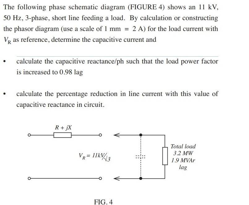

calculate the capacitive reactance/ph such that the load power factor
is increased to 0.98 lag
1/2πfC or 1/ωt
the full question is:
The following phase schematic diagram (FIGURE 4) shows an 11 kV, 50 Hz, 3-phase, short line feeding a load. By calculation or constructing the phasor diagram (use a scale of 1 mm = 2 A) for the load current with VR as reference, determine the capacitive current and
• calculate the capacitive reactance/ph such that the load power factor is increased to 0.98 lag
• calculate the percentage reduction in line current with this value of capacitive reactance in circuit.
So far i have got to:
p.f.=1.9/3.2=0.59
Il=(3.2*10^6)/(√3*11*10^3*0.59 )=284∟-53.8
=167.7-j229.2
unsure which way to go next..

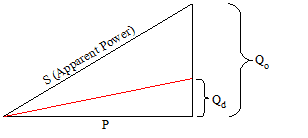

Note that I've corrected a typo in the power triangle that I posted in #4. I had switched the digits in the real power value. Sorry about that. The new figure is repeated here:
I would suggest going first for question part (a), finding the capacitive reactance required to achieve a load power factor of 0.98 . You can work from the power triangle! Add in a line that represents the apparent power for the desired power factor. Something like:
so that ##Q_o## is the starting reactive power and ##Q_d## the desired reactive power. You should be able to calculate a value for ##Q_d##, and hence find how much reactive power the capacitor will have to carry in order to bring the reactive power down to that level.

Note that the value of S will be different for the "new" power factor. Also, I think you've miscalculated the original S value. I don't get 3.2 MVA for ##\sqrt{P^2 + Q^2}##.
It's simpler to find the desired Q via the power factor angle and the constant real power P, so
##Q_{new} = P \tan{\theta}##
where ##\theta## is the power factor angle.

That looks better.
So if the original reactive power Q was 1.9 MVAr and the desired Q is 0.65 MVAr, how much reactive power do you need to cancel out?
gneill said:
That looks better.
you would need 1.25MVAr to cancel out
Right!
So the capacitor that's to be added across the load should provide that much reactive power. Can you think of a way to calculate the reactance (in Ohms) given that power requirement?

You want to consider only the reactive power here. You have a supply voltage of ##V_R## and with some reactance value ##X_c## create the necessary power value (1.25 MVAr). So that
##Q_c = \frac{V_R^2}{X_c}##
Find ##X_c##, the capacitor reactance.
Qc=V^2/Xc
1.25=11^2/Xc
Xc=11^2/1.25=96.8Ω
Almost. What happened to the ##\sqrt{3}## applied to the 11 kV?
sorry,
That now gives me 167.7 Ω
I don't think you're applying the ##\sqrt{3}## appropriately. Remember,
##V_R = \frac{11 kV}{\sqrt{3}}##
11*10^3/√3=6350.8
6350^2/1.25*10^6 =32.3Ω
That's it! So the required capacitive reactance will have a magnitude of 32.3 Ω . That's part (a) of your problem.
