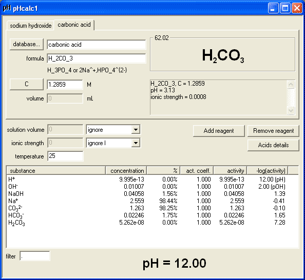

To be honest, I am too lazy to try to solve it on paper. I haven't spent substantial time writing this pH calculator to do these things by hand :-p
pKa1 = 6.37, pKa2 = 10.25, for NaOH pKa = 13.8. Ionic strength ignored completely.
You need 1.2859 M of carbonic acid (that was done by trial and error, but when you are shown pH immediately after entering concentration it takes almost no time to converge on the right answer).
