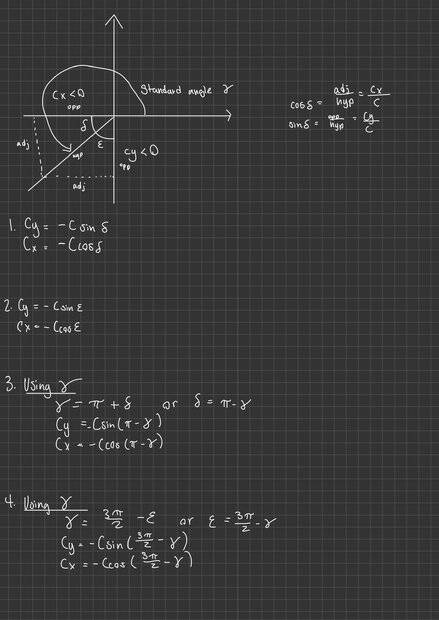

I am not sure if I did this right as it wasn't as complicated as I think the solution should be and I couldn't find anything online as to how the solution is even supposed to look like. I inserted an imgur link of my answer in case the image on here isn't clear: https://imgur.com/a/tE28WWu
Calculate the components of a third quadrant vector C in the following ways:
1. use the angle between the vector and the negative x-axis (delta) and apply right-triangle trigonometry
2. use the angle between the vector and the negative y-axis (epsilon) and apply right-triangle trigonometry
3. use the standard angle for the vector (gamma) - that is, find the connection between gamma and delta in the formulas you found in part 1.
4. use the standard angle for the vector (gamma) - that is, find the connection between gamma and epsilon in the formulas you found in part 2.
x component = magnitude * cos(standard angle)
y component = magnitude * sin(standard angle)
1) Correct
2) Wrong. Check yr answer again!
3) What are the generic rules for below:
sin(π + θ) = ?
cos(π + θ) = ?
Apply above result to below to see relation with 1.
Cy = C sin(ϒ) = C sin(π + δ) = ?
Cx = C cos(ϒ) = C cos(π + δ) = ?
4) What are the generic rules for
sin(2π + θ) = ?
cos(2π + θ) = ?
cos(- θ) = ?
sin(- θ) = ?
cos(π/2 + θ) = ?
sin(π/2 + θ) = ?
Apply them to below to see the relation with 2.
Cy = C sin(ϒ) = C sin(3π/2 - ϵ) = C sin(2π – (π/2 + ϵ)) = ?
Cx = C cos(ϒ) = C cos(3π/2 - ϵ) = C cos(2π – (π/2 + ϵ)) = ?

Thanks I've got it now!
