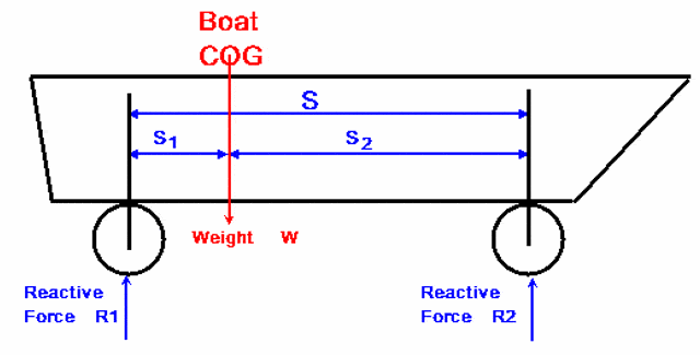

I am building a boat rack for the top of my truck for a particular boat and boat dolly. The boat will be upside down with the beach dolly attached. It is a side loader, so balance is critical. I need to calculate the combined Center Of Gravity (COG) of the boat and dolly before I will have them together to be able to measure it with a hoist. I have come up with a common sense equation for this, but sometimes in physics things that you think are simple and linear are not. Thanks for any information. I don't know if it is the correct term, but I am using COG as the balance point of an object when the fulcrum is placed below the object.
First, I have a rudimentary question about COG that may seem ridiculous, but this is not my field and I do not assume I know anything until I know it.
If I want 75% of the boat weight to be on the rear axle, do I place the Boat COG 25% of the wheelbase(C) ahead of the rear axle?
Now for the composite part. Two objects A and B are stacked and I need to calculate the combined COG of the stack. Obviously, the combined COG will fall somewhere between the two object COGs. Can I calculate the distance (x) that the combined COG moves away from the Object A COG as (Y)*(MassB/MassA) ? In this example it would be Y/4.
No. You need the torques to balance - so if X is the moment arm for object A, then Y-X is the moment arm for object B.
Similar for the first question - you need the force on the rear axle due to the torque about the front axle to be 1/4 of the overall weight.

1. Placing Boat on Trailer: Let's say I have taken a 2" wide sling around the bottom of the 14' boat and hoisted upward to determine the point on the boat where it balances. I have been calling this COG. If I want 75% of the weight of the boat on the rear axle, the trailer wheelbase is 10'. Are you saying it is not as simple as moving the boat COG 2.5' ahead of the rear axle? Is it close? What else could I do?
2. Composite COGs: You say that my simple attempt to calculate the new COG ignores torque. Do you mean that the approximate new COG cannot be determined with the given data? For example, are you saying that when the top object A's fulcrum is moved downward under object B that the original COG of object A is useless information and cannot help determine the new composite COG?

2. Placing Boat on Trailer:
Below, I have tried to adapt some moment COG equations to my problem.
Example: W = 300 lbs S = 8' want to find s1 and s2 for 75% of W on rear axle:
R1 * s1 = R2 * s2
R1 = .75 * 300 = 225
R2 = .25 * 300 = 75
225 * s1 = 75 * s2
s1 = 75/225 * s2 = .333 * s2
s1 + s2 = 8'
(.333 * s2) + s2 = 8'
s2 * (.333 + 1) = 8'
s2 * 1.333 = 8'
s2 = 6 s1 = 2
Is this correct? What puzzles me is that it the same answer as given by my intuitive "Bubba Science" formula:
s2 = S * (% of W you want on rear axle)
thanks for any clarification,
Everything above is right (except mA(y-x)=mBx should read mB(y-x)=mAx according to the drawing) but here's a more direct approach:
The summation of moment (a.k.a. torque) about any point should be equal to zero. Since we can use any point of reference, we can choose the point where the front reaction force is applied. This will eliminate this force as its moment about this point is zero (no lever arm). So the other two moments will have to balance out:
W * S2 = R1 * S
Or:
R1 / W = S2 / S
And because R1 / W is the %W on the rear axle by definition, then S2 / S represent the same value.
Then you can simply find the other values by substraction, i.e. S1 = S - S2 and R2 = W - R1.
