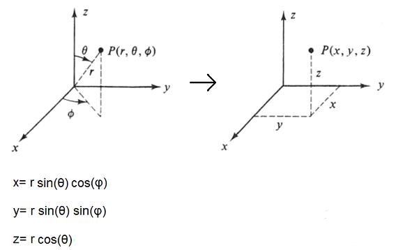

SPHERICAL COORDINATES - I found this on internet: (r, θ, φ) where:
r = Earth radius
θ = altitude
φ = longitude

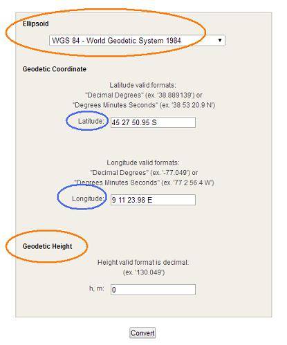

SO SECOND I converted the SPHERICAL COORDINATES into CARTESIAN COORDINATES (X, Y, Z)
(using this website: Spherical to Cartesian Coordinates Calculator)
POINT A (4,483.03, 725.29, 4,468.34)
POINT B (4,483.03, -725.29, 4,468.34)
POINT C (4,483.67, 712.77, 4,469.71)

I'm afraid that θ is the so called colatitude.
That is $θ = 90^\circ - \text{latitude}$.
Oh, and it is not altitude. That's something else again.

So this is not correct after all. On that website for spherical coordinates we need to fill in $θ = 90^\circ - \text{latitude}$.

Than in order to transform the (r, θ, φ) Spherical Coordinates, in (x,y,z) Cartesian Coordinates, I applied this formula:
where
r is Earth radius 6.371.008
θ is latitude
φ is longitude
PLEASE NOTE:
Latitude (θ) goes from 0° to 90°.
Point A latitude is 45.464 which it means it goes from 0° to 45.464°
In order to apply the formula I need the distance from 45.464° to 90° (see θ on the image above above)
So: θ = 90° minus 45.464° = 44.536° So I converted (r,θ,φ) (6.371.008, 44.536, 9.19), in (x,y,z), applying the formula using this website: Spherical to Cartesian Coordinates Calculator
The Cartesian Coordinates obtained are:

- SECOND METHOD -
The second method is faster.
As you can see from the image below I simply have to fill the DMS (Degrees/Minutes/Seconds) Cordinates, and the website calculate the Cartesian Coordinates.
PLEASE NOTE:
As you can see from the Image above, this website use the Ellipsoid WGS World Geodetic System (which is an International standard used also by Google Earth). The "Ellipsoid WGS" keep in consideration the ellipsoid shape of earth, so the result is more accurate.
Over and above of using an ellipsoid shape instead of the sphere, it is possible to adjust even more the Geodetic Height, according to ASL (Above Sea Level) or BSL, to have a much more accurate result. But in my calculation I left "h" empty as I don't need such level of accuracy.
This is the website link for the conversion: APSalin - Free Online Tools - Geodetic To Cartesian Convertor
