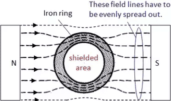

Yeah, the presence of the external "uniform" magnetic bias field can be quite complicated to deal with, but maybe they are saying to assume that the bias field that goes through the core still has the value of the external bias field of ##B_{ext} = 0.35T##. That will not be true in real life because the presence of the high-##\mu## material will concentrate the external field into the core. But figuring out how much that concentration is requires numerical simulation usually.
So if you assume that the bias field in the core from the external field is 0.35T one direction, and the saturation field is 1.56T (the other direction), what coil current does it take to generate a field that counteracts the bias field and takes the core to saturation?
Here is a figure showing the situation in real life, with magnetic field concentration due to high-##\mu## material (I could only find this image for a magnetic shield, but you get the idea...):
https://qph.fs.quoracdn.net/main-qimg-5c58b3c4b703301c80059e5005c4a215.webp

your correct this is a "real life" question this will be a coming experiment .
In a sense how do I calculate the extra current to overpower the persistent magnetic bias field. I guess my question boils down to when calculating the current required for the H(A/m) field to cause B = u * H to be 1.56 T. To over come the bias is it the difference between negative bias and the positive saturation?
Bias = -0.35 T
Core +1.56 T
Difference = 1.91 T
so I would need to drive an H field to generate 1.91 T swing in the core using its µ value even though the core could not get that high and it directional thing or to overcome the bias field do I have to calculate enough current using B = µₒ * H "ie" free space until B goes from -0.35 T to 0 T, then use B = u * H "core" till it hits saturation.
I guess I need to know if I use the cores u or or Vacuum µₒ when overcoming a external persistent bias field the coil is in? or if I am missing something else lol.
